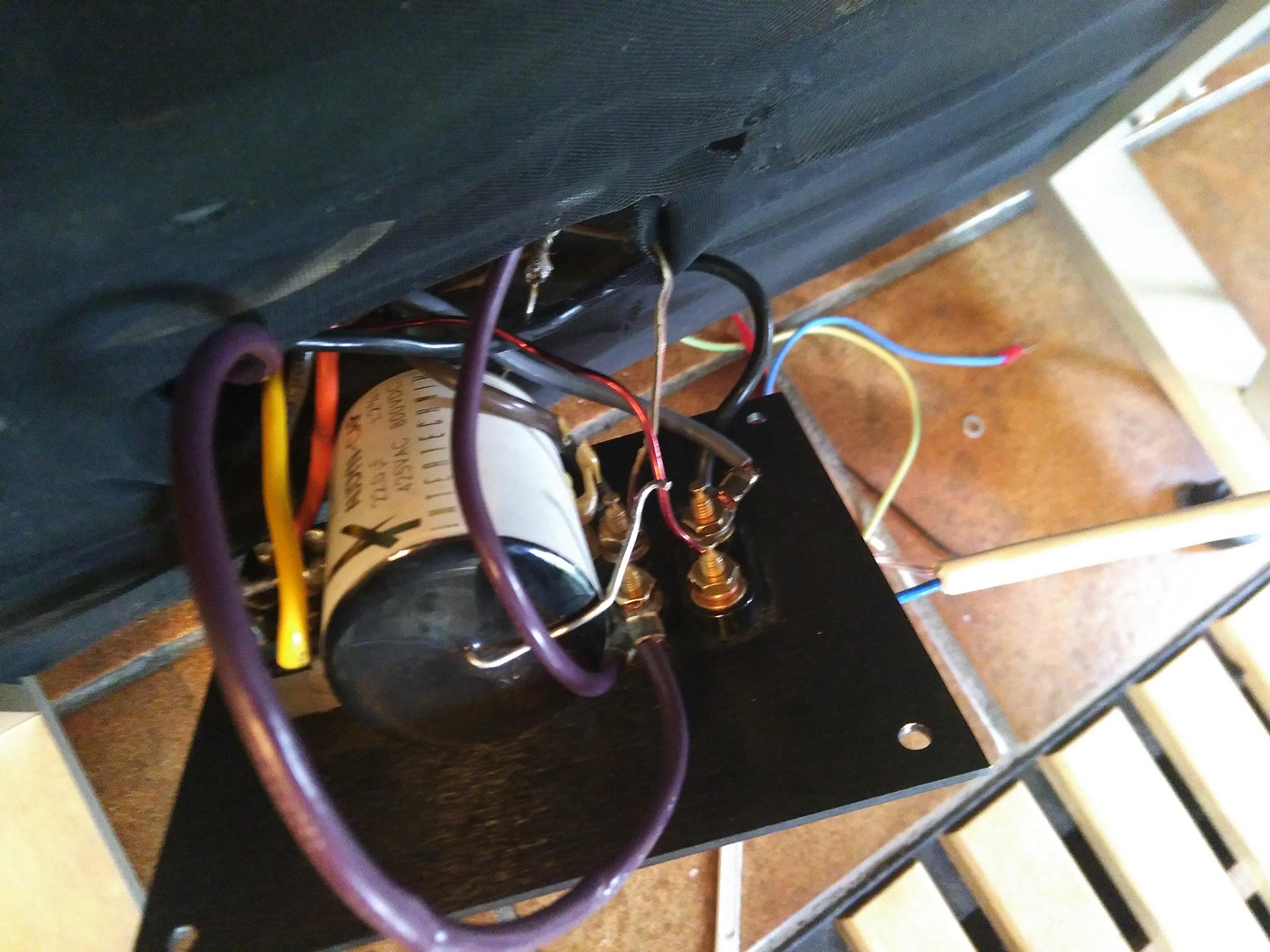

Hello all,
I am changing the Apogee Duetta Signature crossover from active to passive and I have opened the panel where the speaker binding posts are. I have a few questions:
There is huge 22mF cap (Audyn) glued to the panel, but other end is not connected. Where should this copper wire be connected?
I have found two purple cables not connected. According to manual there is only one ? Actually only one has signs of wear so maybe I first try with that one? ; )
Photo from back of the panel would be great if somebody still have the original crossover.
Thanks.
Thanks.
Picture tells more than words...
Here is the photo of the crossover. Does somebody know where the 22uF cap should be connected? How about the two purple wires? For demonstration purposes I connected those in the same connector.
I am afraid that I need to open the cover and I will try to avoid that.
It appears they may already be wired for passive operation. The enameled woofer inductor wire appears connected to the red woofer post. (For active operation the woofer inductor would be disconnected.)
Also, for active operation, no additional capacitor would be added like this.
It's unclear whether the previous owner had a clue what they were doing.
I'm sorry, but you will probably need to investigate this further so you fully understand how he "modified" these speakers.
Dave.
Dave.
Haaa... I found the reason as I opened the cover to see the whole crossover. The mystery 22uF cap was there because there was only 5 pcs 10uF caps in the tweeter side. Maybe in the factory they did not have enough 10uF caps anymore and they put one 22 instead of two 10uF. Quick test and speaker was working in passive mode.
