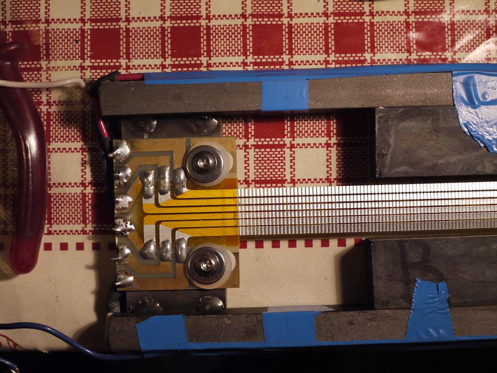

tyu, I did that a week ago on my Diva midrange, was easy to do at the top as they are clamp compression held in place on the contact points of the returns. Had to release the support suspension and reglue when tensioned, all in all a simple job. They sound very good and are stable. I do have new one's coming from Graz, but will keep them for spares. The retensioning idea is only a one time thing due to the corrugation, in my case was 3/8" loss of ribbon lenght to desired tension.
Retensioning the mt-ribbon
Hi tyu, how did you exactly determine how tight you had to pull the ribbons? Did you use something like the 92,8 (or 96?) grams to pull the ribbon straight like Graz and the Manual are recommending or did you trust your feelings?? I own a pair of Minors myself and I'm about to refurbish them, so your advice would be very welcome.
trust my feeling............I had no tensioning pot......my pr were vary lose....I only did it from the top only ...............I just loosened the two top screws ....so I could vary ezely then work the black peace of plastic lose from the ribbon.....I did not take the screws out ...when the black peace was lose from the ribbon.... I just ezzed the white plastic back....it has the wires in it.....it dose not take much............you can line it up by eye.....don't over titn the screws when done.....................................................

@ billshurv: Thats a really nice offer, but unfortunately I live in Germany, so it's a bit difficult to get your tensioning pot lent... But maybe you can give some more information or post a picture, that would be surely very helpful!
@ tyu; Thanks a lot for your reply. I also did the tensioning "by feeling", but I would feel safer if I knew the exact amount of the tensioning weight in grams. I'm a bit a pedantic, I know...

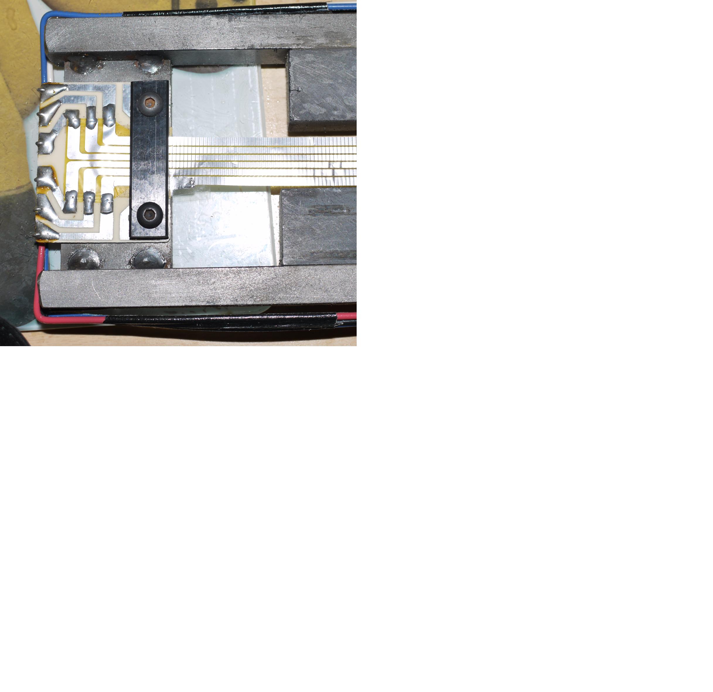

pic 1 of bill.....like all stock Minors MT with the black bars.....
Bill with new Graz setup........look ma no bars.....................thanks bill
