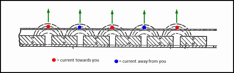

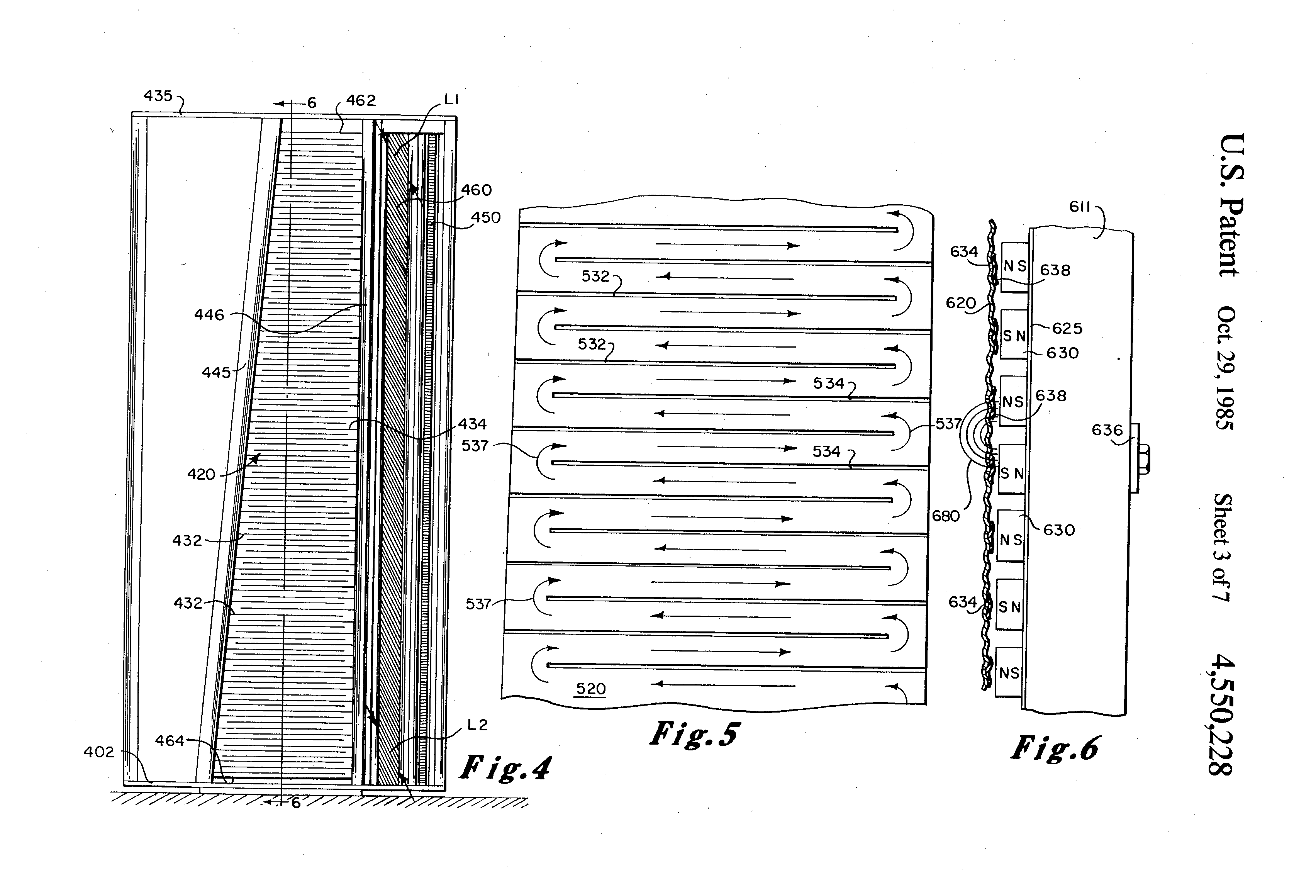

Hey all, just noticed that magnepan and Apogee woofers panels are a bit different in their placement of conductor - Magnepan has conductor wire directly between the N-S magnets, while Apogee has centerline of the ribbon conductors directly over the edges of the N-S magnets.
I would guess that Apogee design not having the ribbon conductor centerline directly between the N-S magnets would compromise their performance, and make it non linear?
See pics...

Apogee's were superior sounding in every way , they were sued by Magnapan for patent infringement and Magnapan won. Both setups with mags on one side would suffer from NL, (maggie) current , push pull setup is superior in regards to NL ....
Yes, I agree a Push-Pull would be ideal, but maggies and Apogees were more like Push-Don't Push? I was referring to having the conductor directly between the poles as opposed to a bit off to the side...
Anyway, Magnepan sued Apogee over the Diva True Ribbon Tweeter design, I don't think anything else was in question...
What would be lost/gained if instead of a ribbon on Apogee panel, you had an Aluminum wire like magnepan?
