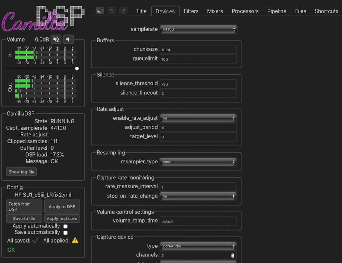

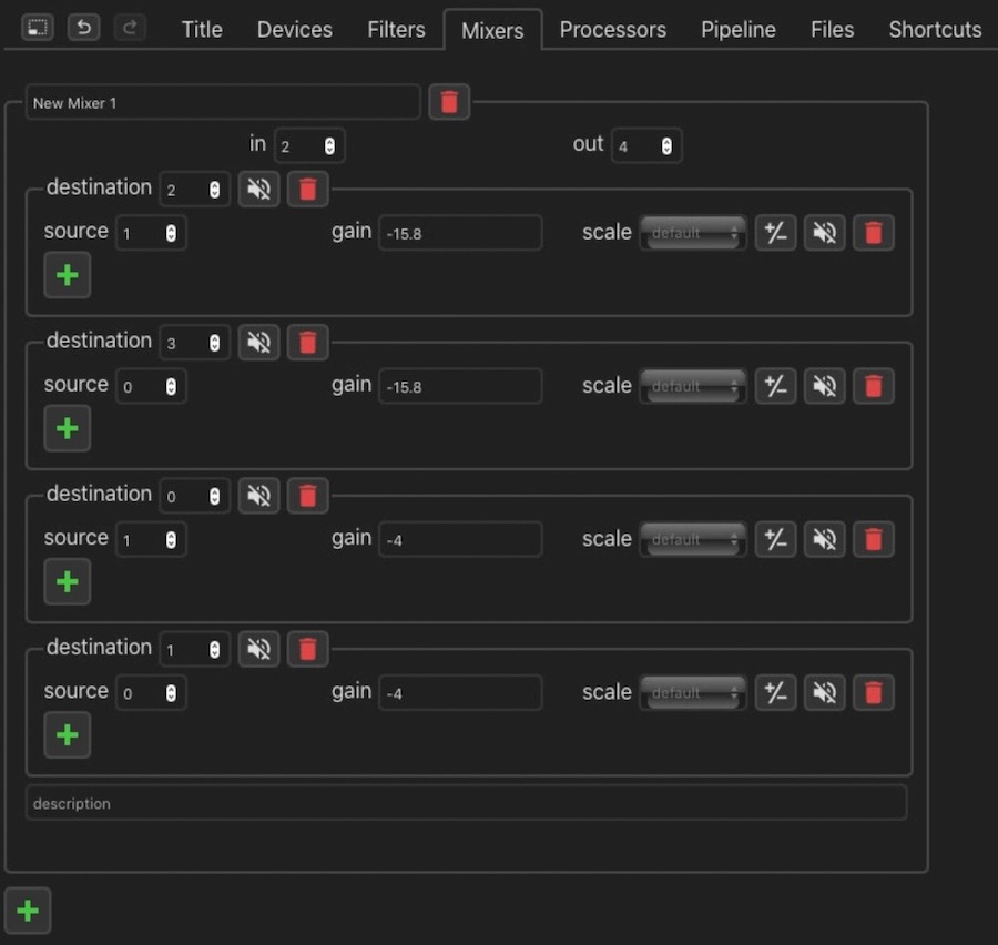

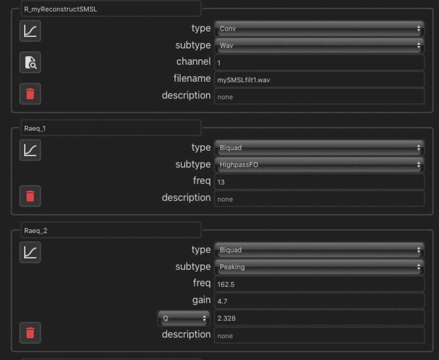

This is a few of the Camilla GUIs that come along with the basic installation:
There is also a command interface and that can be used for interactive control - like measure, adjust, measure, adjust.
One can restart Camilla without almost hearing it so in a measurement session that would not be a problem.
