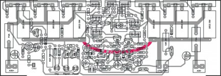

Hi...this is regarding the apex amplifier AX20... When I first tested the amplifier using series load lamp I forgot to connect the two sides of the emitters of 2sc5200 and 2sa1943 together using the wire jumper....it resulted in burning of a 100 ohm emitter resistor of 2SA1837.
Now, after I connected the jumpers together, the 2SA1943 transistor sect ion is consuming around 2.5 amperes...what does it indicate ???? They are getting warm but the other transistors are OK....the lamp gliws brightly..... I am using a + - 35 volt dual power supply
Does it and indicate a short in the 2SA1943 transistors...???? All of them are getting hot....but not extremely hot. I suspect problem in drivers too....
Please advise....

I checked the output transistors..all of them are receiving .6 volt bias.... But the BD139 is receiving only 0.2 -0.3 volt bias only.....the 2SC5200 transistors are having zero bias voltage.....they are not heating up .......
Another interesting fact is that the pot which controlled the biasing voltage of the BD139, is varying only up to around 600 ohms, thus putting the BD139 at a maximum bias of .3 volts only....
Here are my findings :
2SA1943 seems to be biased at 0.6 volts....but 2SC5200s are at zero bias
BD139 is biased at 0.2 volt only....the pot which controlled its bias, didn't moved after a value of 600 ....ohms....I will try a new trimpot....
Though I didn't care much, the 3 LEDs were also not glowing....leaving the other two leds, shouldn't the power led turn on ????
I used bc547 instead of bc550 as in the pcb.....I hope it won't contribute to my problem....
Remove the load, then set the offset <10mV with respect to ground.
I suspect that the offset is high, we have two fundamental parameters on amplifiers: quiescent current and offset voltage.
