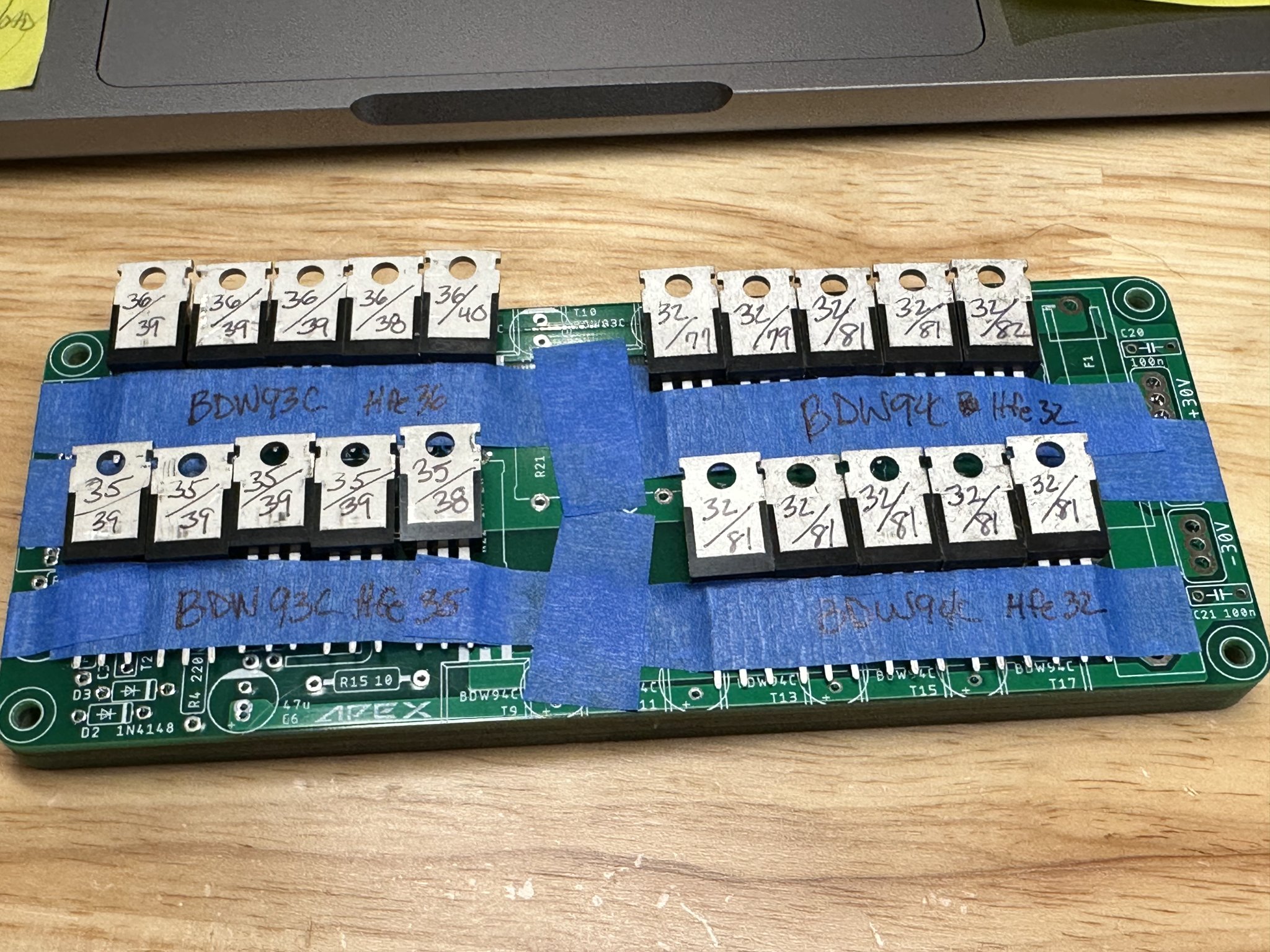

Good idea here chermann, specific amplifier build details get swallowed up in the huge "100W Ultimate...." thread.
The AA9MD is almost at the 'next up!' status. I wish I could add more build details other than the BDW's are sorted and ready to go!

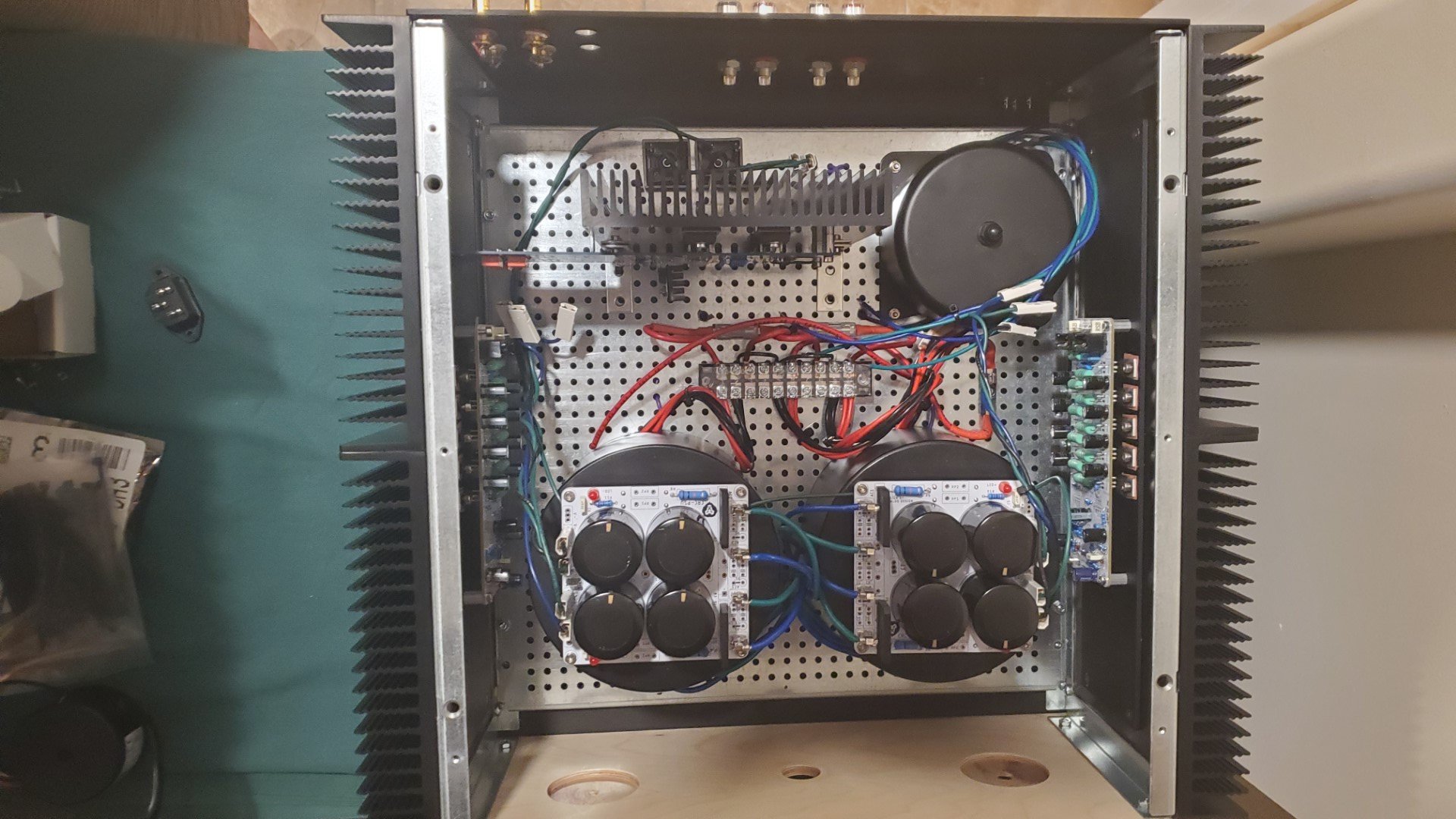

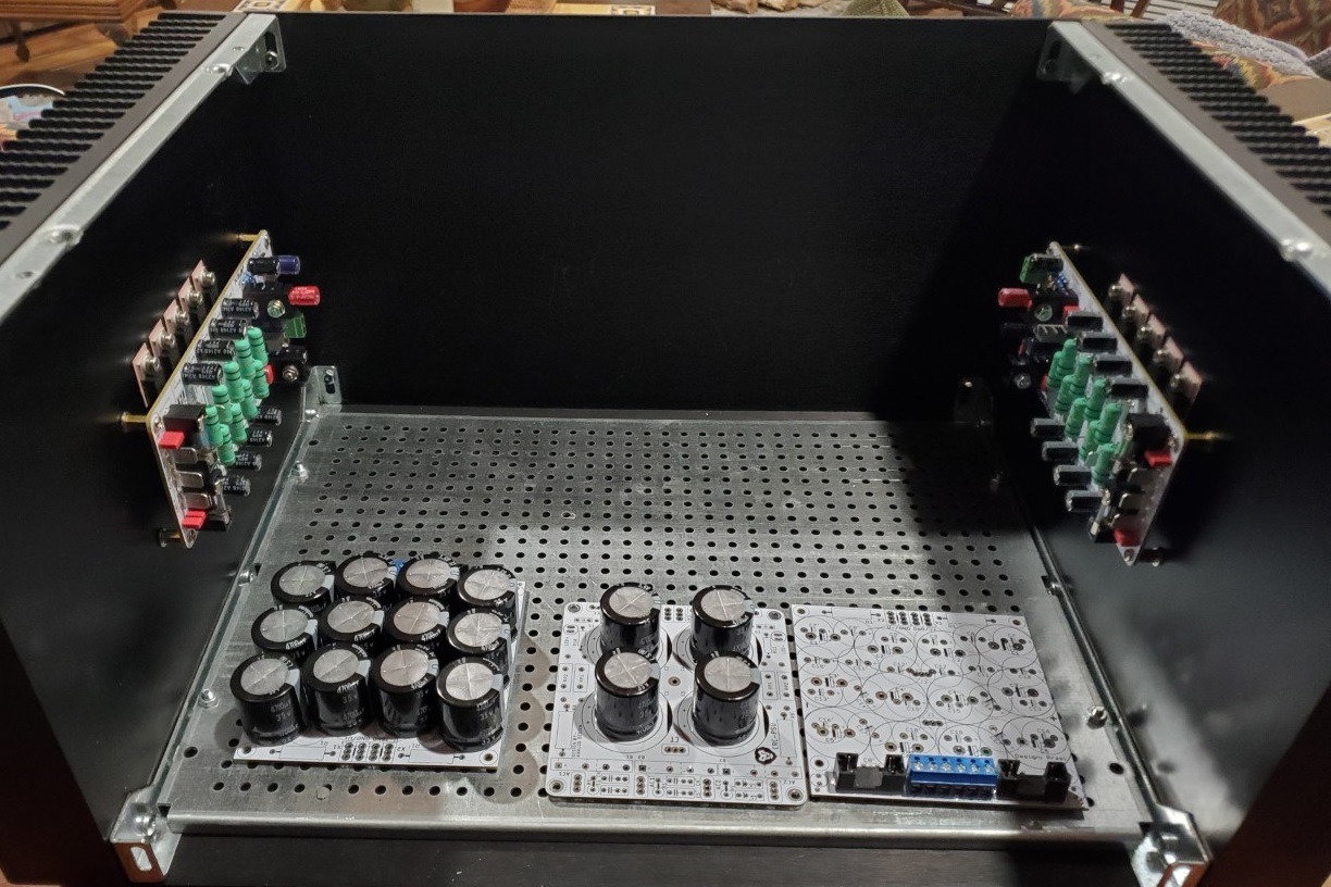

This is one of 3 AA9MD stereo amps in the works.
Bulk cap boards will be installed and more can be stacked. I can try adding more cap boards and see if I hear improvements.
Any thoughts on using a regulated PSU for the front end. Will this amp benefit with a reg psu. I might try it before final wiring.
Thinking Ultra Bib. lots of mounting space available on faceplate or rear panel.
Transformer(s) - Leaning towards One 500VA Antek running 2 Power supplies with bulk cap boards.

Q1: do you try BDW93 B too?
Q2: How do you match that?
as i learned from power MOSFET in reading different comments it makes sense to "warm up" the O/P device nearly to a realistic operation conditions = about 45-50°C then measure the VGS...here the Vbe.
i do that with a heater resistor on my test rig heatsink.

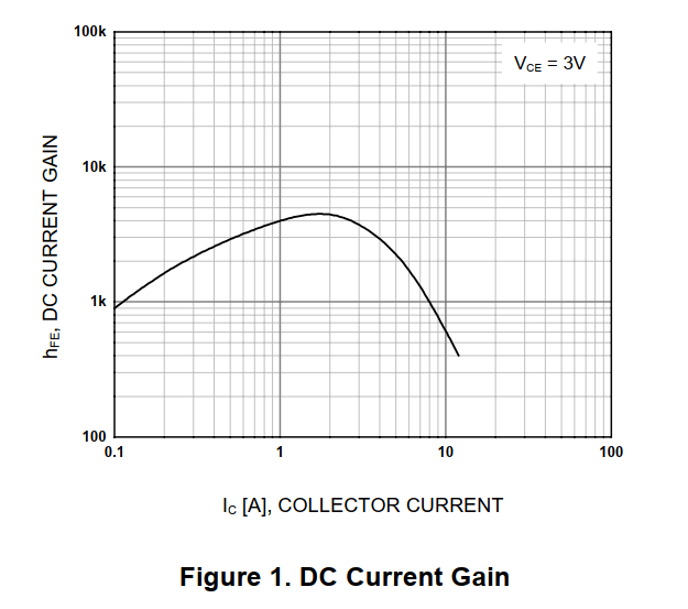

Q3: is there a need (design) to use BJT with high hfe like 1000hfe. figure 1 shows @ 3Vbe and ic about 300mA 2000hfe.

Hey Vunce, what brand are your output devices? Your matching is close!Good idea here chermann, specific amplifier build details get swallowed up in the huge "100W Ultimate...." thread.
Joel your AA9MD is Sweet!

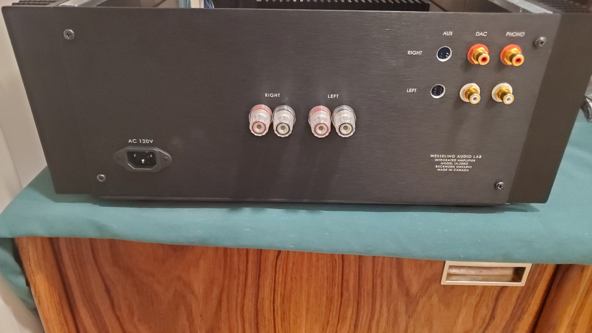

I'm building a second Integrated for a friend. He loves the sound.
I see STM 93c an 94c are available. If I purchase a batch, I don't know if they will be even close enough to get a close match
Photo 1 and 2 is the AA9 integrated. I'm using aluminum for heat spreaders along with thermal transfer tape under the spreader and between the 2 piece heat sinks. Front plate to be etched and will mount 46 step goldpoint attenuator.

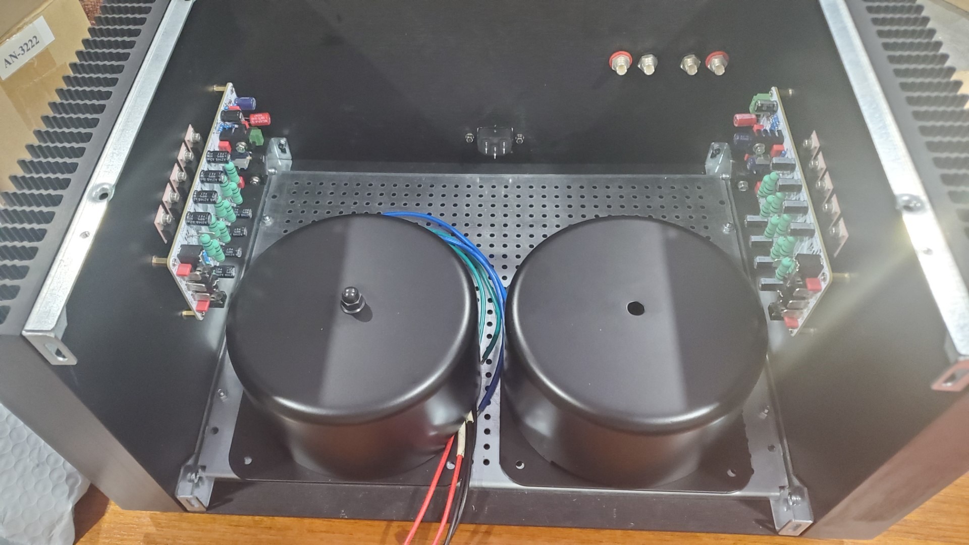

Photo 3 is 1 of 3 AA9 dual mono power amp. Recent delivery of Antek transformers and covers..
Fine build Joel. thanks for your pics.Photo 1 and 2 is the AA9 integrated. I'm using aluminum for heat spreaders along with thermal transfer tape under the spreader and between the 2 piece heat sinks. Front plate to be etched and will mount 46 step goldpoint attenuator.
The white PSU boards are by prasi and the rectifier is on it.right?
the 3rd heat sink is a capX?
the third transformer is for what?
