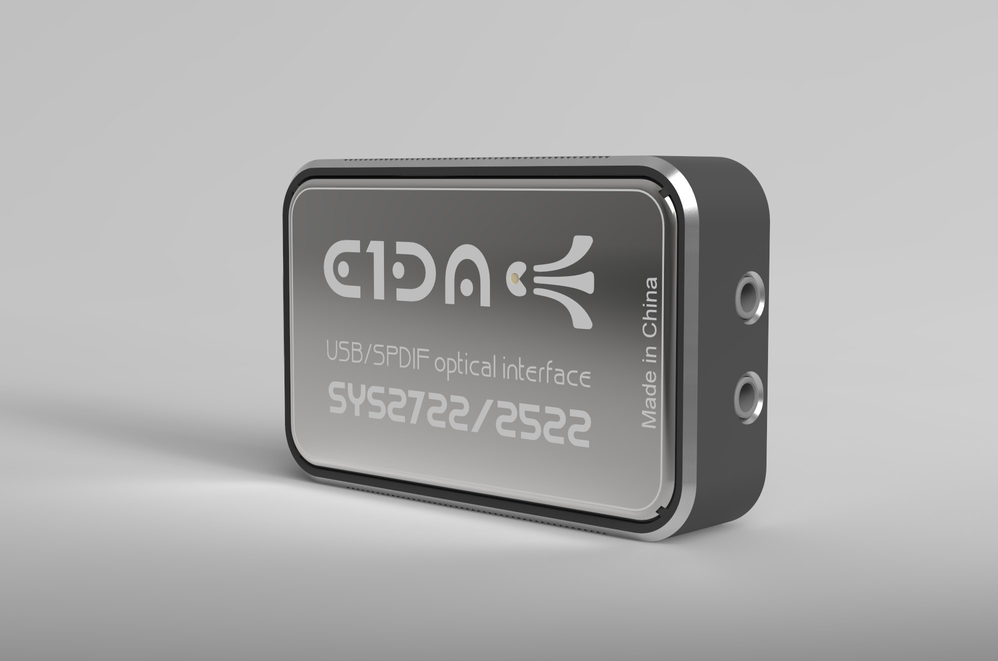

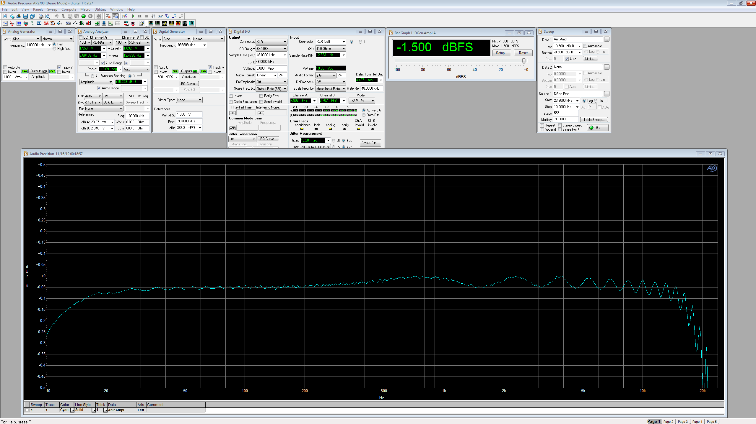

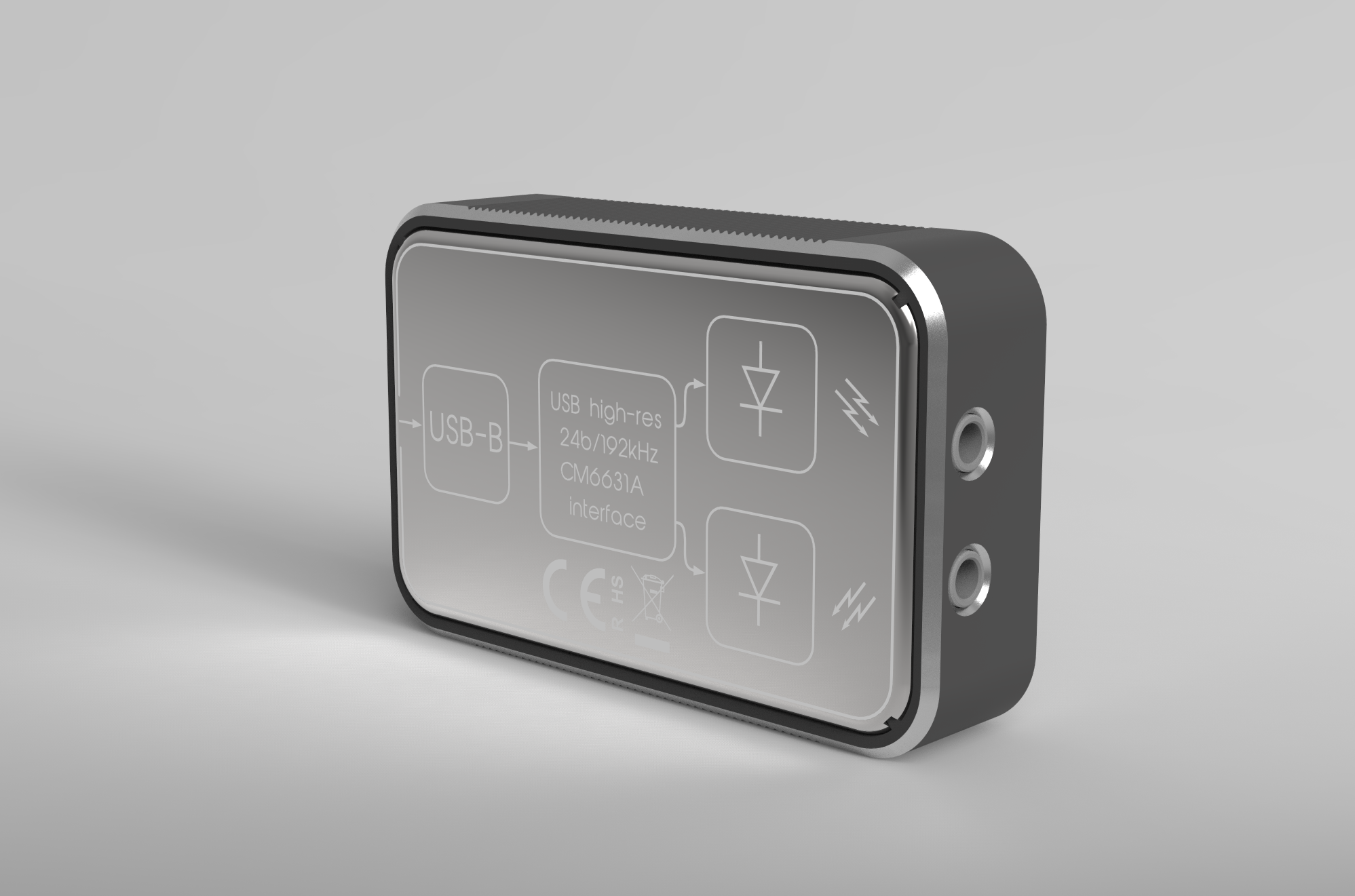

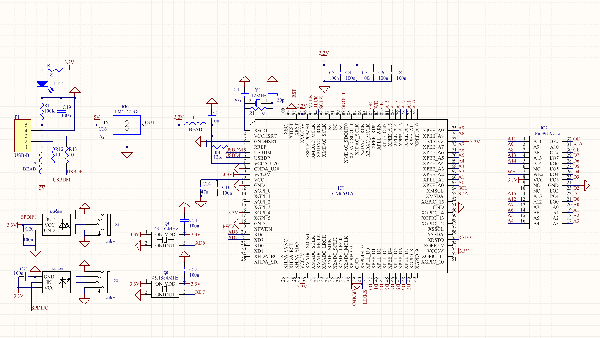

Today I want to tell you about how to make useful the DIO part of an old but well old AP SYS2722/2522, which has only SPDIF I/O and quite useless nowadays. I have to use my AP with my USB DACs and SPDIF/TOSLINK I/O no use, hence, I losing convenient features of the AP2700 software(don't tell me that external sweep is ok too!). To make my AP "great again" I made a simple USB "SPDIF" optical bridge with 24/192 IN/OUT at CM6631A and default FW. See the attached schematic. Now I can make a fast and precise frequency response or THD+N vs frequency etc. After the external sweep, which drives me crazy, now I feel much better.

CM6631A is a USB-audio device controller with SPDIF in/out. IMO any soundcard with SPDIF inputs/outputs could be used.

axismundi, how do you can use 2722 digital generator with USB DAC test if 2722 has SPDIF digital outputs only? I didn't find the way to use it and made that USB/SPDIF 24/192 interface device for that.
Absolutely, there is no way unless you improvise. Which is what you did.
On paper one could imagine a SPDIF to USB-host converter, removing the need of routing through a PC. One could connect the USB DAC to this host rather than through a computer. I guess doable but compatibility will be the key limitation, USB audio is not quite the best of the standards around.
You did not mention whether you encounter any limitations, would you mind commenting on that? Thanks
So to make sure I understand it correctly: you take S/PDIF output from the 2722, convert that to USB, send that USB signal to the DAC and analyze the DAC output with the 2722?
