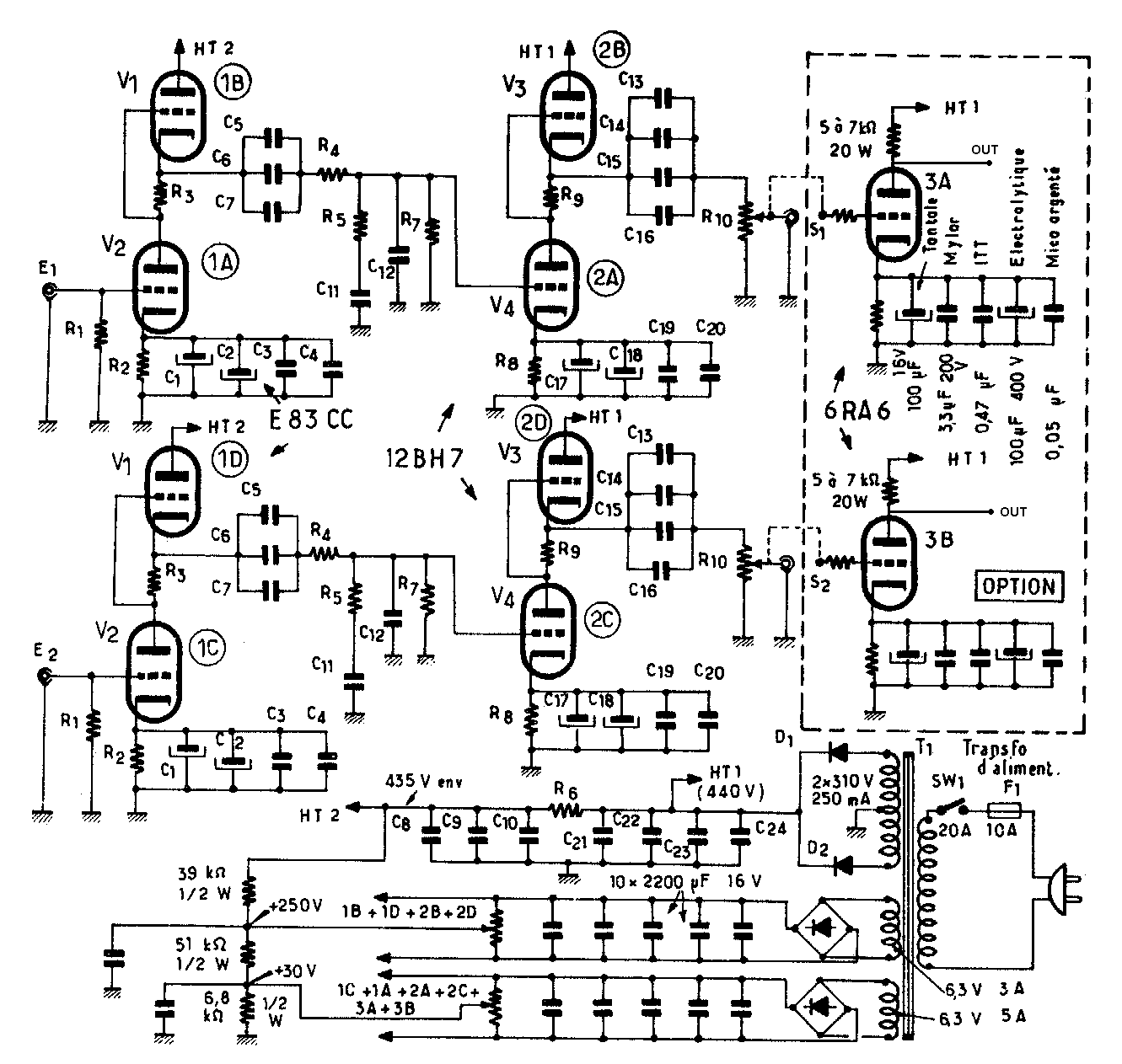

The Anzai preamp i bought in the eighties had a slightly different riaa filter.
The riaa stage had 2 tubes each with a decoupling capacitor in the power supply. The line stage with one tube was also decoupled. If i remember right the power supply at the line stage was around 280 volts, then a 3k3 wirewound plus a 22µF for the output tube of the riaa section. Then another 3k3 plus 22µF for the input tube.
There was another design by Hiraga published in number 21 of l'audiophile magazine. I was told to copy this power supply and use it for the Anzai. Later i changed it into choke input which is always a good thing if done right.
greetings, Eduard

Hello,
I saw publication/scan about the preamp in nr21 on the internet And i am sure i did see the Anzai SRPP circuit diagram here on diy audio.
I moved a lot of publications up in the attic. I will search within a few days.
greetings, Eduard

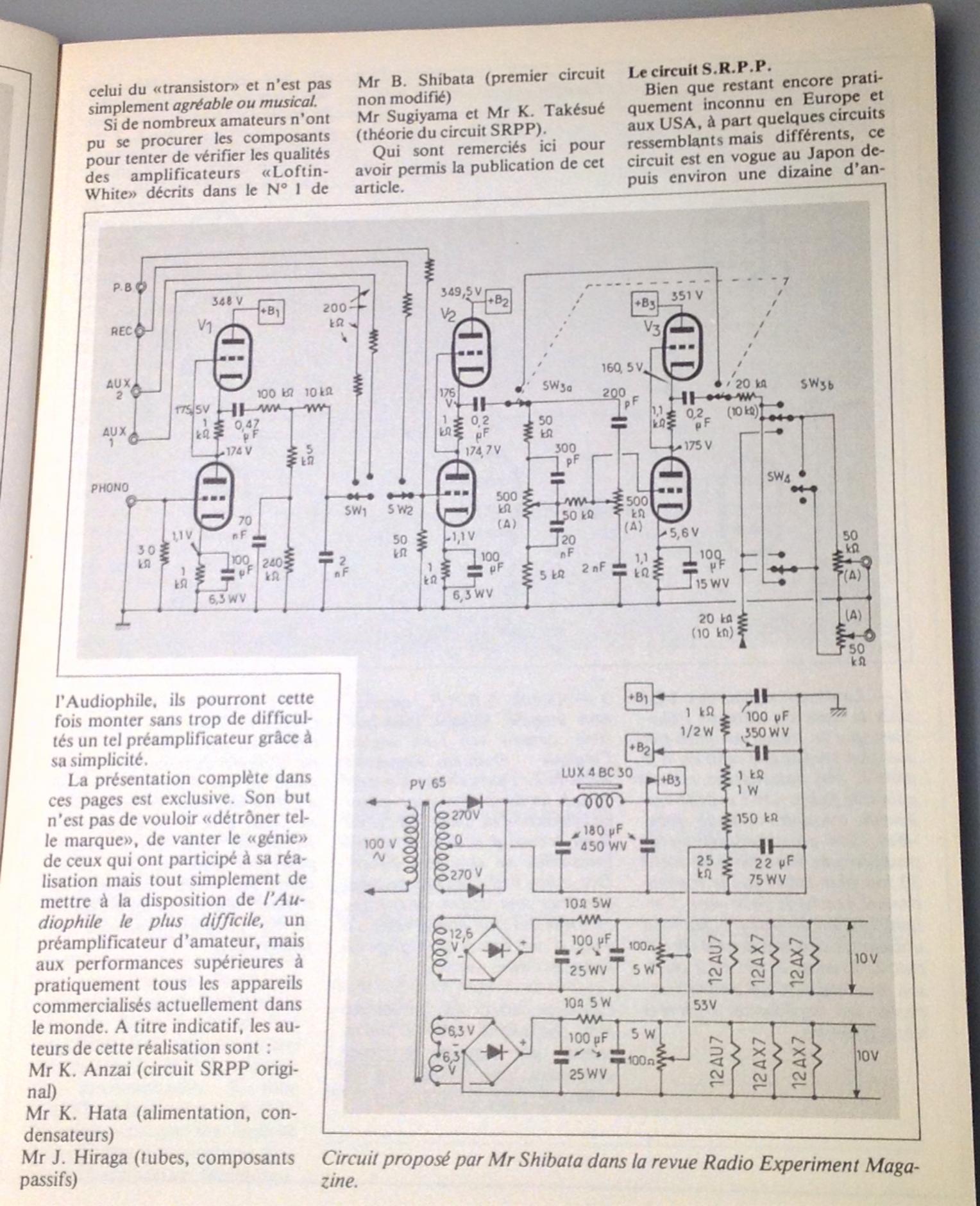

Have a look for another interpretation (italian style)by Bartola
Hello,
That one is from l'audiophile magazine too!
And here you the use of higher voltage power supply too.
Hello,
The one i got was deliveredid with E83cc input. second tube ecc83 and line stage ecc82.
Usually there will be something missing in the french magazines.
Jean Hiraga RIAA Phono
This is the power supply i start using after using the original one for a few months and after talking to people in the shop in Paris. As said before later i changed it into choke input.
Hiraga Preamp
You see google is easier than going up the attic lol.
greetings, eduard

It's schematic version from Mr. Shibata 😀Have a look for another interpretation (italian style)by Bartola

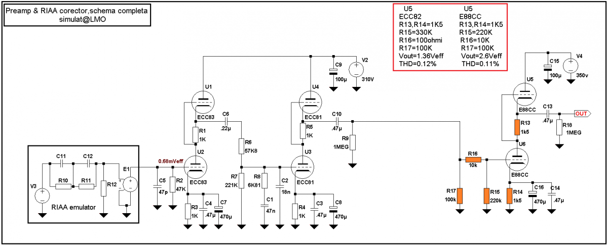

For those interested, I created a spreadsheet for calculating the voltage amplification (gain [dB]) and output impedance (kohm) for various tubes. Input parameters are µ (voltage gain of tube), gm (transconductance), Rk (cathode resistors, lower tube Rk NOT bypassed!), and Rl (load resistance).

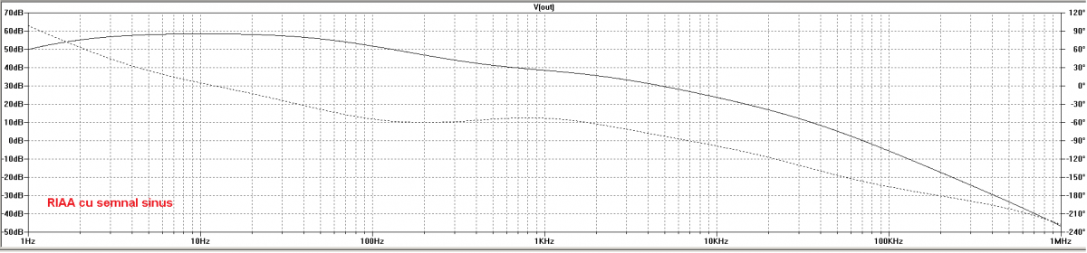

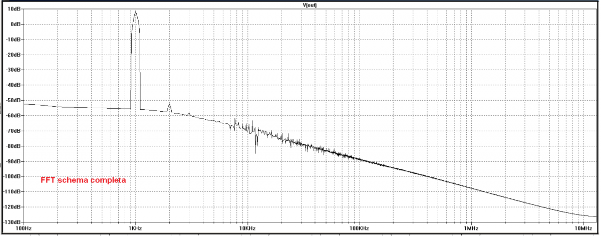

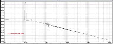

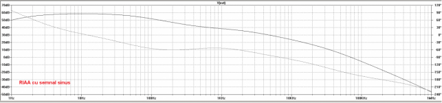

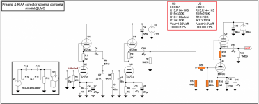

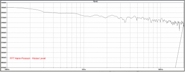

Here you are some sim of my project:
