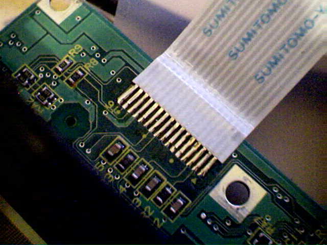

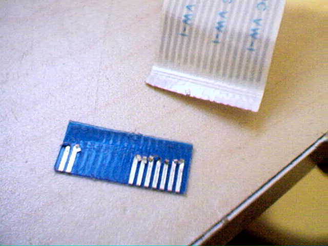

anyway to fix this
can anyone tell me if there is anyway to fix this. please!!!!!!!!!!!!!!!!!!!!11
if not i must sell it and i would like to keep it
it is a end of a ffc cable.
In several instances I have sanded about 1/4" on one side of the end of such cables to expose the traces and plug the cable back in. I would be very careful, but it has worked for me each time. Obviously the cable is not as stiff as the blue tab that came off, so reinserting the cable into the socket takes care and wiggling.
