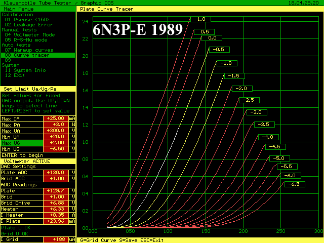

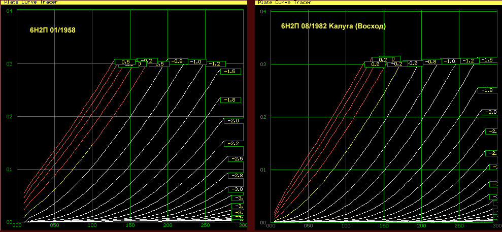

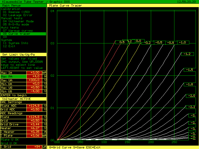

6N1P is similar to 6DJ8... Less transconductance and higher heater draw, but similar gain. 6N2 is like 12AX7 but it has slightly bigger balls. 6N3 is like 5670...6N1 is pretty similar to 6922 isn't it? Gain would be somewhat on the low side for single stage so I might end up cascading anyway so I figured the 12AY7s that I have lying about ought to do just as well with less heater current. I do have some 6N1Ps so I could try those too. For some reason my 6N1P model does not work when configured as a CF. Not sure what the problem as Ayumi models are usually pretty good.
It looks like 6N2P has lower Cg-p than a 12AX7. Too bad I have 40 of the latter and none of the former. 🙂 6N3P looks a whole lot like a 12AY7.
I take that back. I just tried again and the model is working fine.
