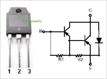

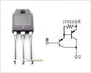

Would the internals make any difference if all other parameters are close ?The TIP147 has an extra resistor and diode.The Sanken not.In this case 2SB1559.
I am not proficient enough to answer that question I am afraid...
That said the selected Sanken parts have more than once been substituted for the TIP by various builders/service technicians/tweakers, you name it, so I just followed that path (read: "I am a painting by numbers guide").
I figured (worst case) the diode could be added on the PCB if needed, at least that's my understanding when comparing the 2 datasheets, but again, I am NOT the guy to ask...
EDIT: adding the 2nd resistor externaly is not possible, but after reading various threads for nights, I understand it's not suitable for audio anyway..

Coolnose, the diode is there for protection. There is also a big difference in gain.
Regards
Jan
My question would be "did you match them in any way" ?
EDIT: yes, for the diode thanks! Needed ? Maybe...
As for the gain I understand the gain on the Sankens is much higher, but looking at the datasheet it climbs with bias, I will be putting 20mA on each transistor only, but maybe I am not understanding this correctly anyway 😉
