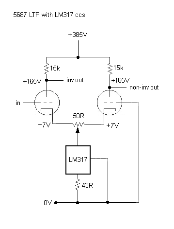

Anything horribly wrong with this (LTP w/ LM317 as CCS)

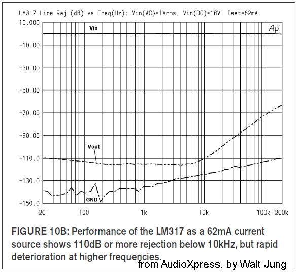

FYI, if you want a high compliance CCS with a low voltage budget (i.e., avoiding a negative supply), a bipolar current mirror will do well. Without emitter resistors, it is possible to have constant current down to 0.1V or so. However, the Early effect is exaggerated, so the current will be noticably higher at, say, 10V (it's not a very constant current).
This approach, though sound in theory, has a non-obvious caveat - the emitter resistor in the mirror 'CCS' needs to have as low as practical value, in order not to take up the available voltage - with monolitic double transistors you might even get away with no resistor at all, using only the emitter bulk resistance.
If you do this, expect an unexpectedly high noise level! The problem is, that the mirror transistor in the 'CCS' forms a cascode with the triode, and since the gm of a BJT is orders of magnitude larger than that of the tube, the whole circuit will amplify any noise at the mirror transistor's base, including that of the transistor itself, roughly Ra/Re times, where Ra is the plate resistor of the triode, and Re is the (bulk) emitter resistance of the 'CCS' transitor. In practice, this may well be on the order of 1000 - while the amplification factor of the whole amplifier may well be less than 10!
The simplest solution is to use a negative rail. This gives you a wide choice of Re versus early effect, whatever type of CCS is used. Otherwise, expect a battle to find the compromise solution, where neither the noise nor the early effect will be optimal. paralleling multiple low nosie transitors may help by alowing each transistor to pass a current better suited for a lower noise figure.

I've never heard of noisy current mirrors. Where do you propose this noise comes from? It certainly isn't the Johnson noise of the effective emitter resistance, which is a few ohms.
If noise were as serious a problem as you seem to suggest, there would be an awful lot of low-noise integrated circuits that would never work.
Tim
The problem is not alarming in most cases, especially if you are using differential outputs, the noise would be common mode.
What I was pointing out was that a voltage noise source presented to the base of the current mirror might get amplified quite a lot because of the Ra/Re ratio.
If I remember correctly, a few years ago someone made a case for using higher reference voltages for standard single transistor current sources, where current is (Vref-Vbe)/Re, to exploit a higher Re in order to increase the CCS impedance, and to reduce the amplification factor with respect to the reference source, this is just another example of the same principle.
