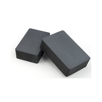

How much more power do you think it will give to replace my magnets with Neo ? 3 Db ?

I don't know if you are currently using Ceramic 8.
But if you do, the flux is three times larger with NdFeB42.
So it'll be almost 5 dB.
But it is a lot harder to build with Neos and much more expensive.

Iam using ferrite magnets like these
and I have enough to be able to have a double magnet instead of a single all the way, but I read somewhere that it only would give 1 db
But I am well pleased with the sensitivity that is now and do not think it is the work and money worth switching to neo.
