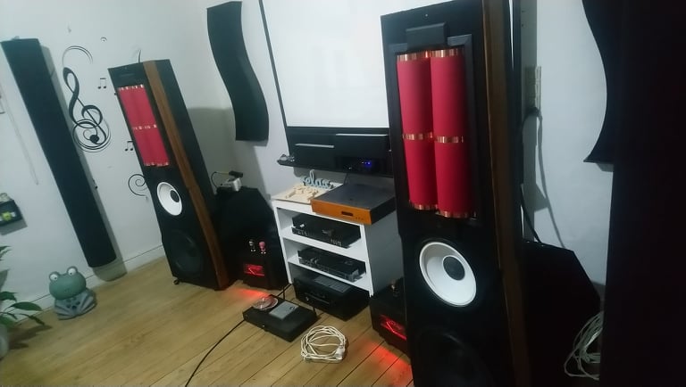

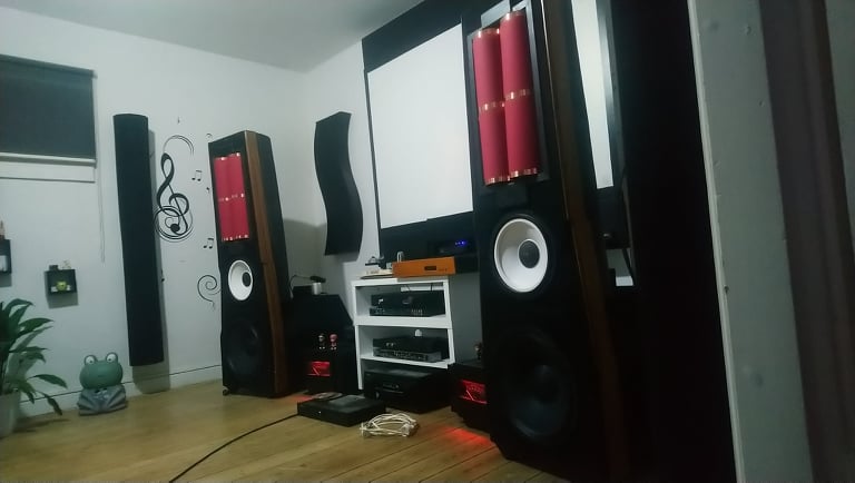

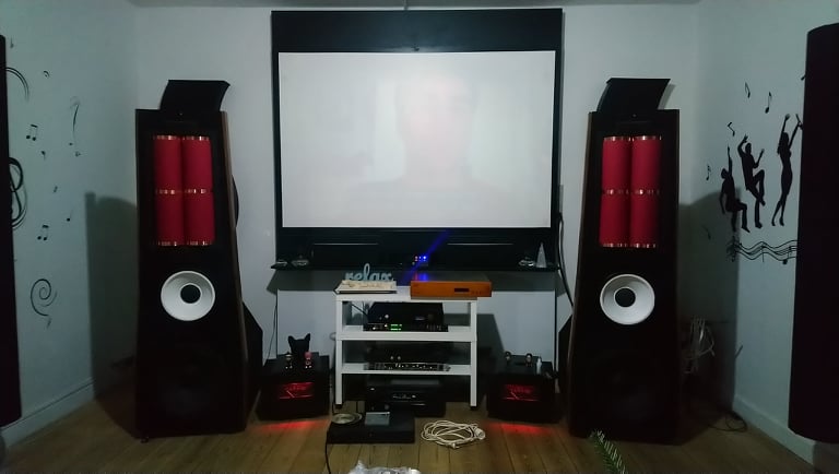

Joppe is exactly the person who inspired me to build speakers on the rubanoid principle.
It turned into over 50 different membranes and just as many voicecoils.
I then expanded with a fostex 12" (Edgeless) from 300 to 80 Hz and from 80 to 14 Hz 2 x 15" in closed chamber (one on the front and one on the back) with Motional feedback and it all active with DSP.
The Rubaniode get a little help from about 14 KHz from af AMT tweeter placed right under the Rubanoide. The AMT have a 0.5 uF capacitor in serie and parallel to the Rubanoide.
The capacitor are two Russian 1uF in serie and battery powered
Overall, it took about 1½ years to get this result which I am extremely pleased with, it is actually the best sound I have ever had
So thank you Joppe 😉
Heres some pictures
Measurement of both speakers from listening position
Red = Right
Green = Left

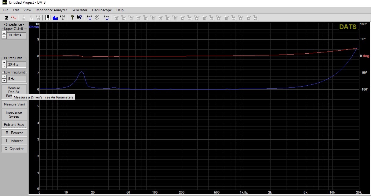

And here is a impedance and phase measurement of the Rubanoide

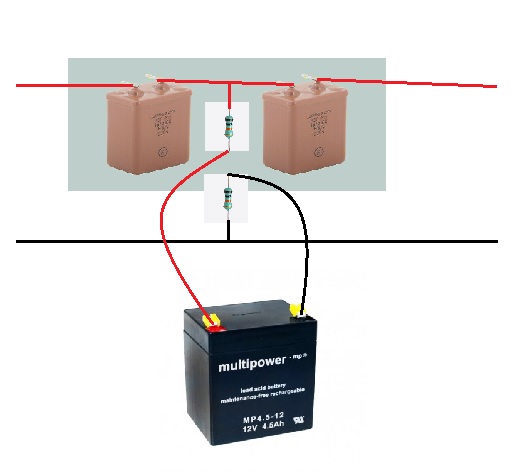

The capacitor are two Russian 1uF in serie and battery powered. battery power ?? waht are you powering ?

you said The capacitor are two Russian 1uF in serie and battery powered. battery power ?? what are you powering ? caps dont need power ? by the way the drawing makes a dead short 🙂 haha
I think Infinity used batteries that way many years ago. Is there not something called biasing of capacitors? Maybe that is only for electrolytics?
Thanks Joppe
The battery to the capasitors is an old JBL "thing" and Primare uses it in Little 16 and Big 49 speakers too.
Is a pre bias "thing" and its not making ad dead short cause of two resistors 😛

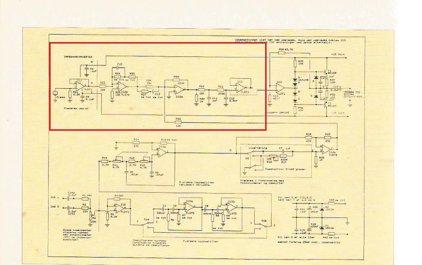

The MFB is from a Danish magasin (High fidelity) and is easy to make and really cheap
Iam only using the components in the red square cause my pre amp and DSP can do the other things

Aah thank for the paper to !!! I see i need glases i thought the 2 resistors where connected........ whoopsy theb it would be dead short. I myst not look at this kind of thing this early in the morning by the looks of it haha. Sorry 🙂

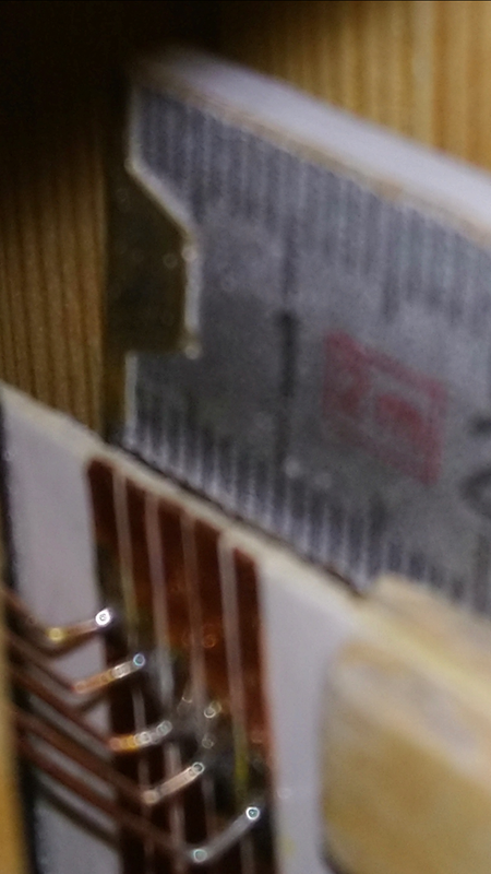

The voicecoil is made a little in a slightly special way. (the picture probably tells the most)
But there are snail tape cut into 2 mm strips that are placed in 2 x 5 on each side and all i serie (about 6 ohm) and a flat carbon fiber between for more vertical stiffness
I have soldered them together with the inner wire from CAT5 cable (stiff, thin and light weight)

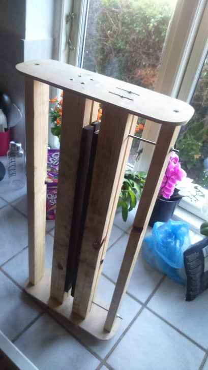

The nylon thread suspension is made with screw and nut so that it can be adjusted both for placement in the magnetic gap and FS
Important is where the membrane are mounted in the sides, i found the best sound with a soft window list and not pressed too much, it gives a god damping

Voicecoil:
Snail tape
Cat5 soldering (Disregard my finger it has been in a milling machine) 😀
Nylon thread suspension (the picture here is one of the first attempts with that suspension so it looks a little fun)

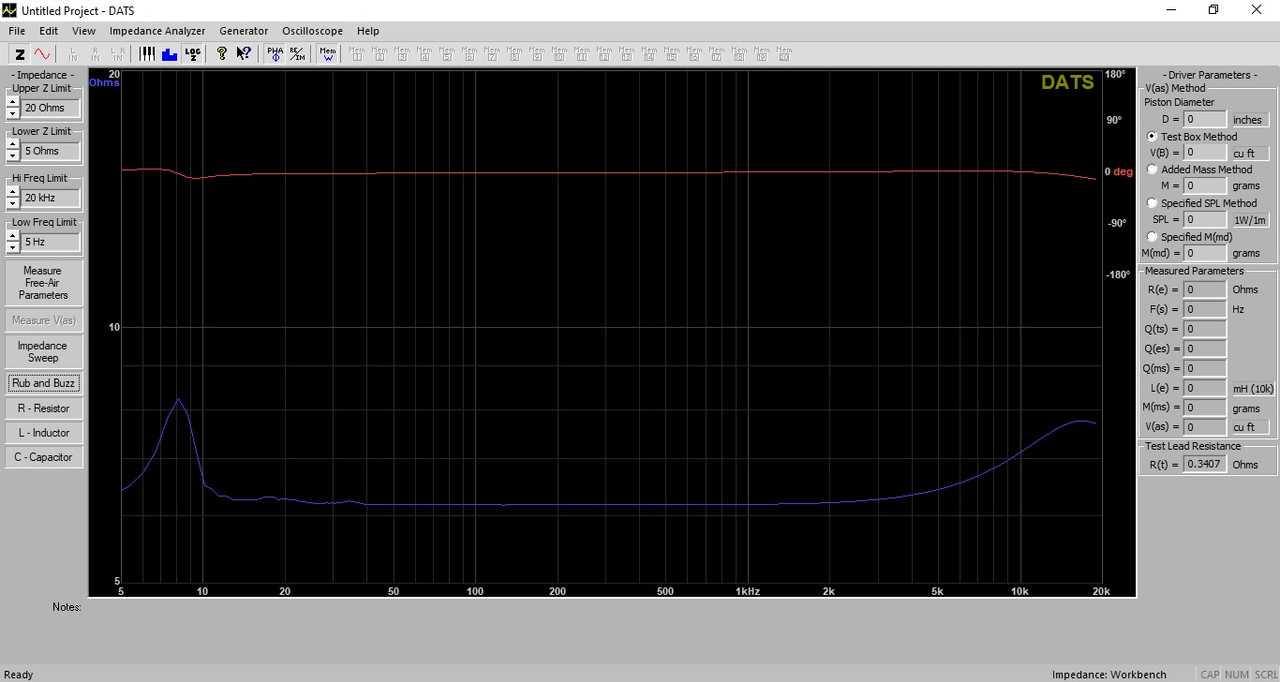

With voicecoil the weight is 72 gr, and if i dont tightens the suspension up the FS is 8 Hz

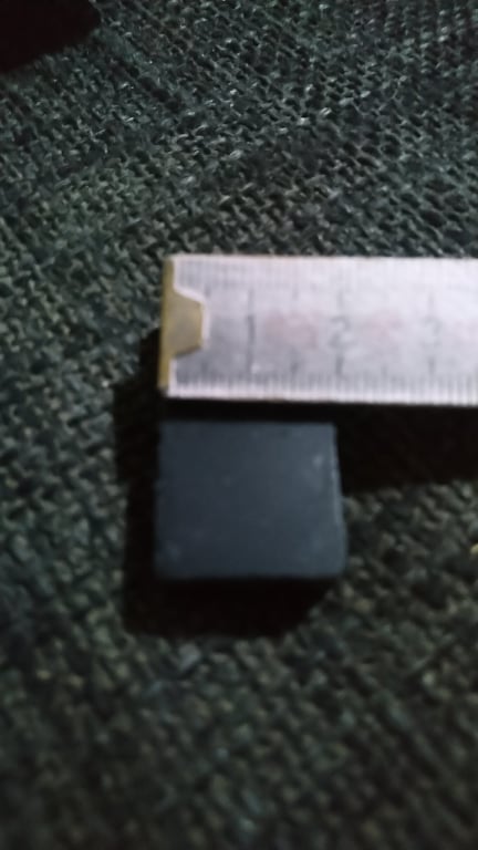

But the voice coil´s copper is 10 mm widely and the magnet are 20 mm. So the voice coil can move +/- 5 mm and still be in the magnetfield/gab.
And it maybe moves 1 to 2 mm when i play really loud (+ 300 watt in the 6 ohm the Rubanoide are)
If the voice coil should move out of the magnetgab i have to play fullrange with them
