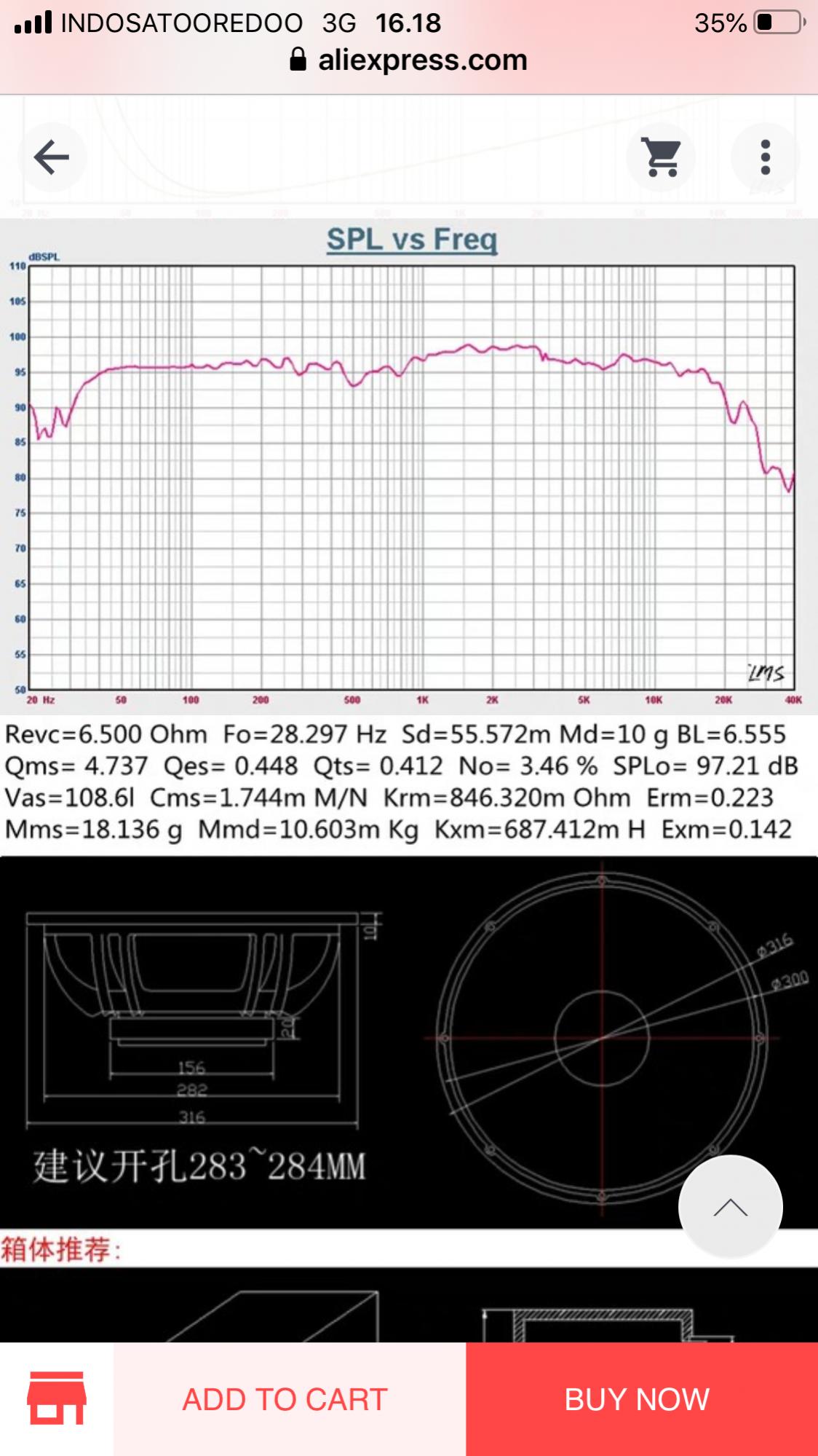

Hi Kaffimann,
Thanks for the link. Well at least we get some specs here. Sensitivity & FS might be over zealous though. Q looks high, does this mean that it can't work on a BLH cabinet ?

It can; be prepared for it to be of 'manly' proportions though if you want reasonable LF gain / extension (less an issue if you're OK tuning higher & a classical pro-audio type balance).

I was going for the roundabout way of asking desired enclosure size before giving the verdict, but without running any numbers I can imagine a fairly hefty BLH for 28hz loading 😀
Complete gamble on this driver IMO, but you never know.

The values don't appear to agree with each other. Qe, Qm are fine for the stated Qt (more or less). But the rest go completely pear-shaped; for example, if that Qt is correct, & ditto for the given Re, Mms & B*L, then Vas can't possibly be what is printed (and so on). This is not implying the driver is bad, just that there are major inconsistancies with the spec. as shown above from aliexpress.
