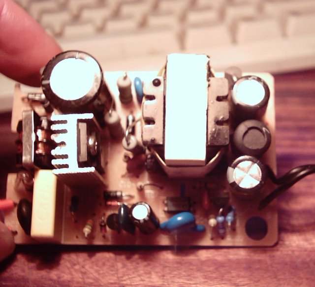

Here is a picture of the ones i use, 100-260v @ 50-60hz input, 12vdc 1200ma output, fully filtered, EMI aproved, fully regulated.
Can be had for $10.

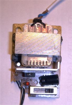

Here is a picture of the €4 powersupply, exellent for fans, you can adjust the speed on the fans with the switch 1.5-12V if you are a diy:ers take it apart and put it together again. 🙂

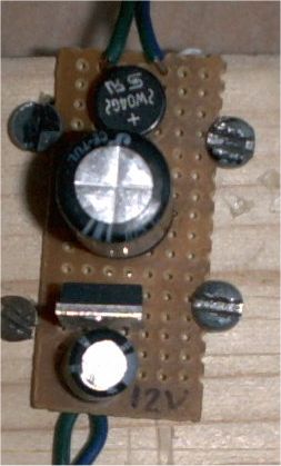

12v 2A Power Supply
This is a diy-forum so I just want to show how a Diy-powersupply look like. I use the one in the picture as a powersupply to my preamp-phono-riaa-stage, I think it took 2 minutes to build it. As the headline for this thread says this give 12V 2A (2000mA), cost for it €2 - 3 without a transformer. A cheap 12VAC 2A transformer, can you find in a 12V halogen lamp.
