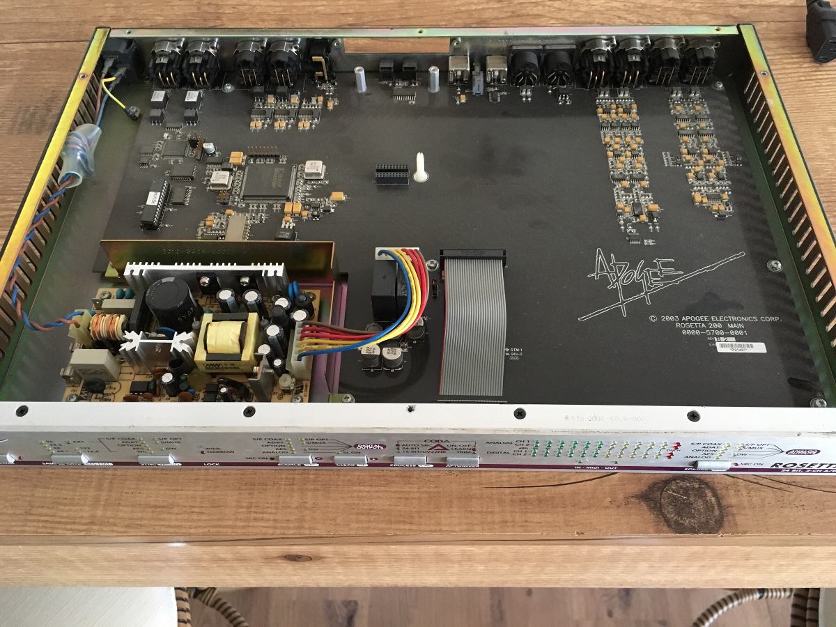

by the way i am attaching the pic of a dac i have. The noise is very low indeed and it uses what looks like an off-the-shelf smps Maybe they have added some passive filtering i do not know.
Passive filtering i understand can be very effective at suppressing some residual ripple out of these smps
If they are good for this professional unit they could be good also for my silly prototypes i guess
But without measurements it is very hard to say
What i am thinking to do is to get a mic preamp battery powered, crank its gain to maximun and listen to the sound of the ripple out of this bloody smps ... maybe i will cook my brain
I'm seeing a high proportion of XLRs there - where do their pin1s go?
well ... i do not know Can i check that without open it just with a tester ?
I am not using it by long time. Also because it is balanced and i want to stay unbalanced ... more in line with my nature 😱
Actually this balanced thing i do not understand well. Let's take a preamp for instance ... i should see 4 independent identical preamp lines starting from the volume attenuator with 4 sections.
Instead i see balanced preamps that are stereo inside ... just with an op-amp at the input and maybe another one at the output. Is this not cheating ?
Balanced on the outside and unbalanced in the inside
