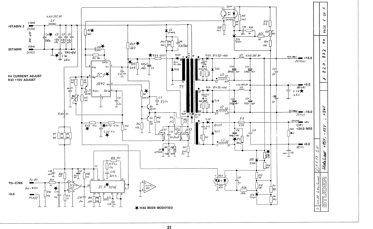

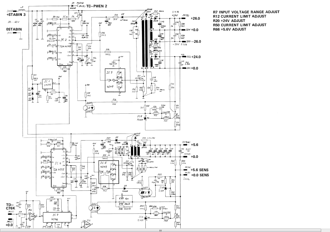

YES , Studer A820...A827, the analogue recording industry's standard for a few decades ...It's actually full of switching supplies,heavily shielded , except the lower noise circuits have additional liniar regulators...
That's hard to do. The SilentSwitcher has a pair of post-switcher linear low noise regulators.
The switching part makes sure they can be fed by a USB charger or, for total isolation, a Powerbank.
But to maintain very low noise there's the linear low noise regs.
