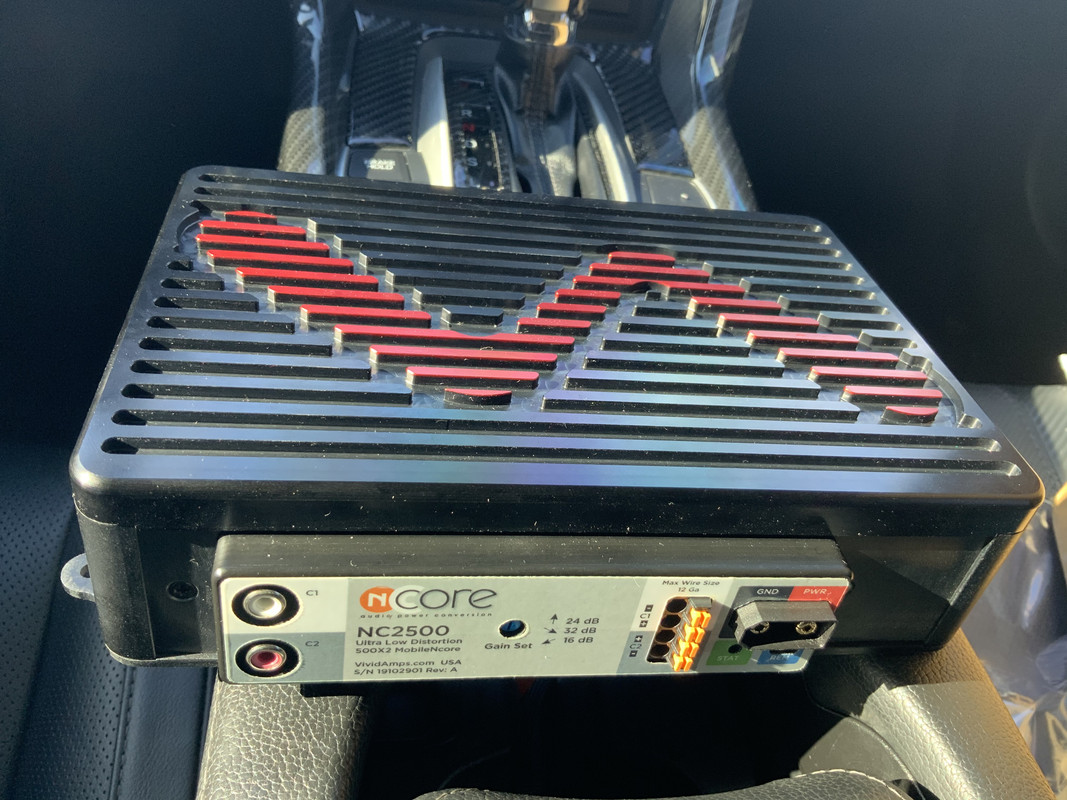

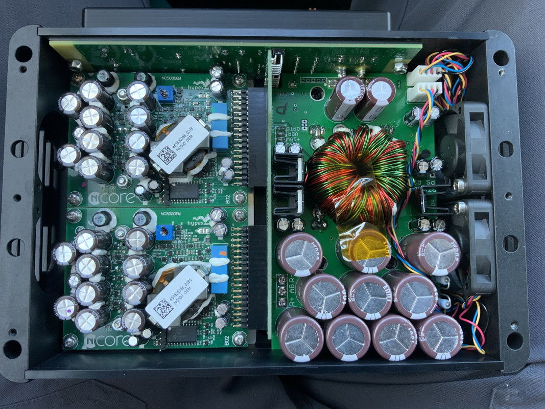

NC2500 = 2 x 500w NC500OEM modules

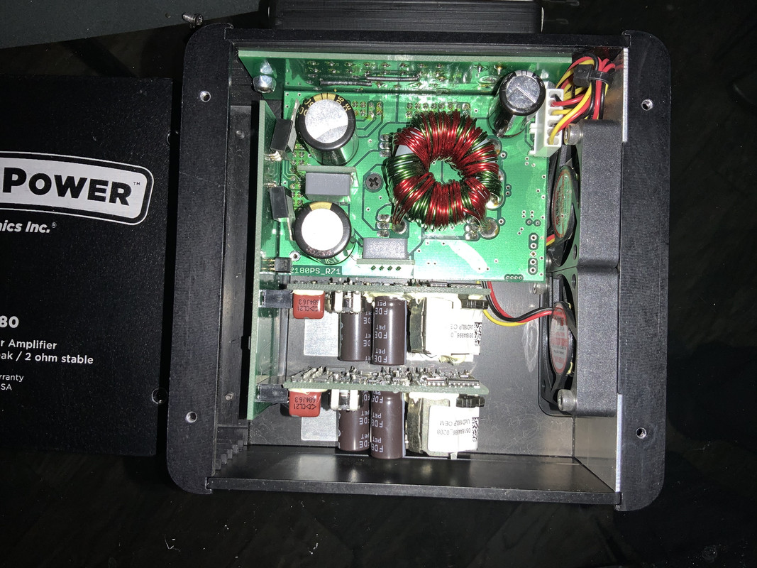

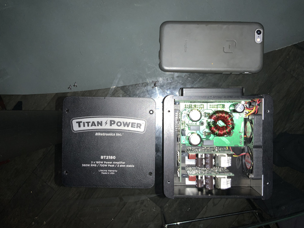

You’ll notice my BT4180 and BT4250 bear a custom logo which Biketronics is able to accommodate onto the cover for you if you desire in place of their stock plate design.

The amps are very stable thermal wise due to the extremely high efficiency of the Hypex modules, it’s overbuilt power supply, and the two internal cooling fans.

Single gain pot for both channels on NC2500
The speaker output connectors can fit 14awg. Bare wire works but is tedious.
The terminals are specifically designed to use Deutsch Novello connectors. Makes things a lot easier. They push in and ‘clip’ in very secure.
BT2700-2 the NC2500 supports 12Awg speaker wire. It specifically had the more traditional Weidmuller Spring-Cage speaker terminals. So regular 12ga ferrules will work.

I have my Biketronics amps installed in a 2016 Civic Sedan on stock alternator. Efficient power houses that don’t require you to upgrade your electrical.
Specifically in my build I have a Class A tube buffer circuit that sends the analog signal out into the inputs of Class D high efficiency amplifiers for dynamic speaker power.
A match made in heaven.
* A stock of iFi iTube2 units that feed:
* Biketronics BT4180
- 180 Watts (4ohm) x 1 - Front Center Passive 2-Way Component
- 180 Watts (4ohm) x 2 - Rear R&L Tweeters
- 180 Watts (4ohm) x 2 - Front R&L Tweeters
- 180 Watts (4ohm) x 2 - Front R&L Midrange
* Biketronics BT4250
- 250 Watts (4ohm) x 2 - Front (R&L) Midbass Drivers
- 250 Watts (4ohm) x 2 - Rear (R&L) Midbass Drivers
