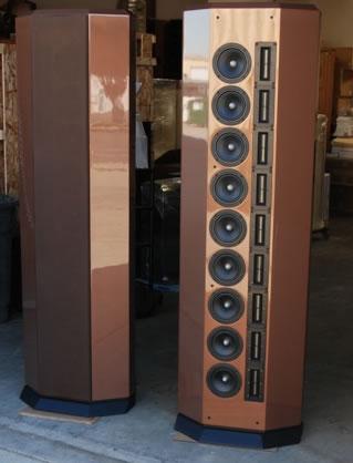

Built a line array for a customer a couple years ago using the ribbon. A very nice sounding system indeed.
Good Listening
Peter
What frequency and what slope did you cross these tweeters over at? Seems to me that used in a line array like this the Fountek CD 2.0's should allow decent output levels without objectionable distortion at considerably lower crossover points than would be acceptable with a single tweeter.
And, wow, these Fountek ribbons are QUITE efficient, a bunch of them like that - wow- you could probably drive them with your LINE PREAMP.... hahaha- or maybe directly off your CD player. (just kidding of course.) 9 tweeters would add about 25~27 dB to their 97 dB 1 watt 1 meter sensitivity... 120 dB+ at 1 watt 1 meter, wowie zowie.
If the midbass drivers are also somewhat efficient it seems to me like you could drive a pair of these from some low power amp, like a small Pass Zen amp, or Pass First Watt type current-source amp, a Jungson class A DIY amp, or some little 300b SET type thing. One of these days I'm going to have to build some kind of high-efficiency speaker to play with. I want to play around with some of the low-watt SET amps just to see what all the buzz about them is. I have an 845- based SET amp with about 20 watts a side and some good speakers that are about 93 db 1 watt 1 meter and it sounds good but I am not hearing the "glorious" sound that others rave about. So I thought I'd try (some day) a pair of high-efficiency array type speakers and maybe a Bottlehead SET of some kind. Just a thought.
