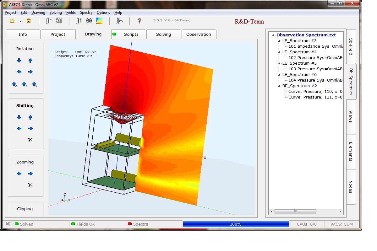

I suspect a steep learning curve to generate the 3D mesh models and get a BEM sim running. The shapes are irregular for most speakers and not likely to be in a std library. I'm looking for suggestions and possibly experience to avoid dead ends. I don't mind point tools and post processing images as long as the docs are good.
I'll trying to make a OmniDirectional speaker, I have another thread on this forum http://www.diyaudio.com/forums/multi-way/303941-omnidirectional-work-progress.html that describes it. I'm currently trying to improve the HF performance and will be directing a circular waveguide into a reflector (shape TBD). There are other issues as well and I thought time domain BEM would be the best bet as I'm looking for reflections and interference patterns. Ideally the entire speaker is simulated so GPU-CUDA would be a real boost, and I don't mind overnight CPU runs.

Oh that one, I have seen it, interesting concept indeed! For such a system VACS would be the best choice. It is free to a certain degree and your project is rotationally symmetric, except for the sub cabinet, but that can be ignored I think. The Doc is also good as it is made by the ABEC guys.

I'd thought I'd close this thread off, as I can finally use ABEC. I modeled a simple ABC cabinet to get both the frequency response (LE engine) and the sound fields (BEM engine). It took me 3 full days to get to "student driver" level but it is an amazing design tool. It was not a straight forward process (for me anyways), and required lots of trial and error to "infer" some operations by using the examples and help files. This seriously,.. I can't emphasis that enough,.. needs at least few tutorials written up explaining how to use it.
Initial results and others at http://www.diyaudio.com/forums/multi-way/303941-omnidirectional-work-progress-7.html#post5040158
