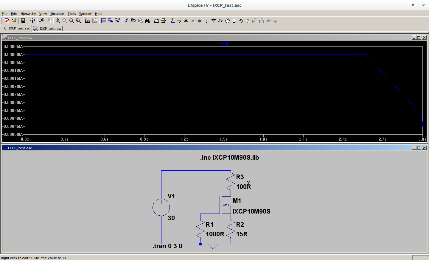

When I placed it into a preamp model using ltspice it doesn't switch on. I thought it might be a simple layout problem so I set up a test model with just a voltage and two resistors - still wouldn't switch on.
Anyone got an opinion whats going on here.

It seems to work ok here.
In your example it doesn't seem to generate a constant current which would be represented by an offset voltage in the output. Or am I missing something here.
Whats the voltage at the top of R5 ?
Can you make a 20mA CCS out of your simulation.

Try changing "NMOS" to "VDMOS" and remove "Level=3" from the .lib file. Here is the anode characteristic, it matches well with the datasheet:
Stripped out the level three and it works, but with residual errors.

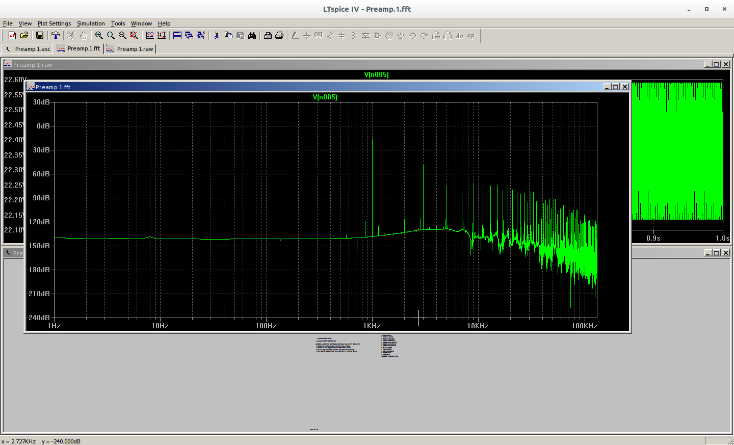

Its working well enough for my simple needs at the moment. Getting quite a nasty distortion profile from a 2SK170 front end - surprising.
