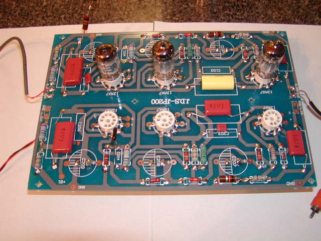

I made the mistake of purchasing several boards (line stage) from them. The first board was supposed to be the (blue Jadis) and they sent me the green board. Rather than go thru the trouble of sending it back I kept the green board and got the blue board for an extra 15 dollars.
The workmanship of the boards is good. They are not even close to being a clone as they advertise. The circuit sounds like **** in stock form. It wasn't until I totally modified the board to be an exact copy of the Jadis that it sounded good. Still have some hum issues to be worked out. Note this is the (Blue) Jadis board.

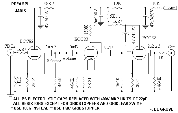

Frank was kind enough to find a copy of the "true Jadis" and post it. I copied this circuit complete with Frank's changes.
Sonically it is quite good now. It has good bass, mids and highs.

Hum (60Hz) and buzz (120Hz/180Hz) can be caused by a variety of things, including but not limited to poor filtration of the supplies, flux leakage from power transformers and often by internal ground loops.
Check to make sure you don't have multiple paths from the board to chassis (e.g.ground plane to standoffs?) and inputs/outputs to board and chassis. All rca jacks should be insulated from the chassis and their grounds brought directly to a common grounding point - alternately you can bus them together at the jacks and bring one ground connection back to your common ground.
Depending on how the filament traces are routed if you are using ac to heat filaments you may have electrostatic and possibly magnetic coupling to adjoining circuitry.
IMHO component quality is really important and I spent a long time figuring out that as an EE I didn't understand why some parts sound good and others don't.. Some surplus CDE and TRW caps sound reasonably good, but you might want to have a look at the REL PPFX, not expensive and relatively free of dielectric effects.
The board layout looks reasonably ok to my eye.

Perhaps if I bought purchased one of their completed boards, I'd have better luck. By the way, is it possible that the hum is from a leaky cap, bad resistor..... faulty component or something like that?
I used ALL new parts. To be honest I suspect a faulty lay out.
One thing to keep in mind is these boards are no where close to the originals that they are supposed to be cloned from.
You could probably do a search and find a schematic for a 6sn7 or 12b4 or something along that line that will blow the Jap boards to the curb. If not I have the green board Jadis clone all stuffed up if you want to buy a finished board. Just add power supply and volume control.

That would be great, but I believe part of the problem is whether the schematic or the PCB are even close to the real design of the Jadis. Do you have an original Schematic?

What you posted is the same schematic that Frank posted for me and what I posted here in a thread about the clone line stages.
It is NOT however anywhere close to the so called "Jadis" clone offered by others on ebay. As you stated in a prior post people would be better off making something and wiring point to point.
