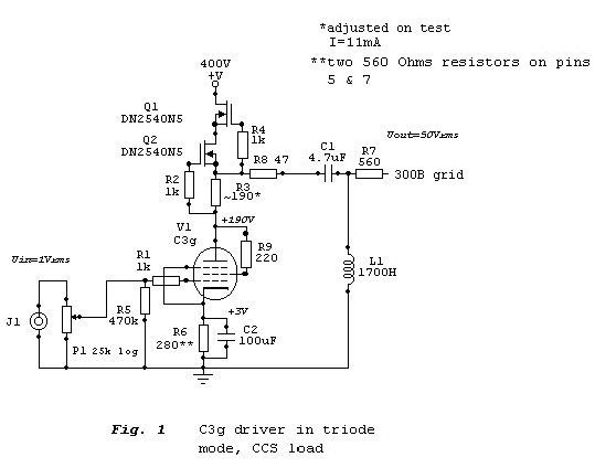

anyone tried this before? i heard it drives pretty well either as a triode or a pentode any possible schematics to share?

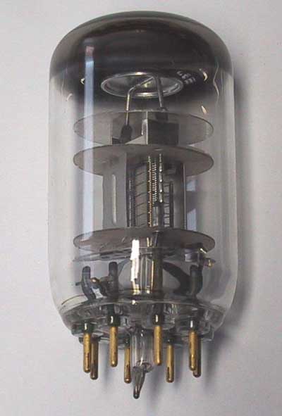

Stixx Member Joined 2003 original-ton.net 2009-12-07 8:24 am #2 2009-12-07 8:24 am #2 C3G is a nice tube, I've used it in headphone amplifiers so far. Connected as a triode and with a CCS on the anode it could be used like this: Also note the delicate construction inside... Attachments c3g9vw.jpg 26.6 KB · Views: 319 C3g_04.jpg 22.1 KB · Views: 284
