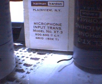

Anyone Use A Harmon/Kardon XT-2 Xformer For MC ?
I should have posted this question BEFORE I won the bid on a pair on eBay.
Anyhoo, they are a 1:14 mic input xformer (250 ohm ct: 50K). I plan to use them with a Denon 103R with a secondary load of 20k to reflect 100 ohms to the cartridge.
I know they will work, I don't know how well . I'm hoping someone here has some experience with these, and can tell me if I either scored or got burned sound quality wise. You know, before I actually hear them to make my own determination :D

Hello , i have tried the XT-3 [similar maybe] with very good results , better than swowter and other mc x formers:)

Excellent news!! They are very similiar...just impedance difference I think 250 ohm for the 2, and 600 ohm for the 3.

Hello, i have two cartridges, one is ZYX RS20-02 and the other is ORTOFON MC30. I have a 27 KÙ resistor parallel with secondary coil, and one 270 Ù parallel with the primary coil , also i use a low capacity interconect cable , the results are excellent, and the sound is smooth and clear .Try something like this...Gianis

Did you have any trouble finding the MIP9 socket for the XT-3?
Did you use the full primary winding or half winding? Wondering what step up ratio you used and if/how you loaded the secondary winding. Which cartridge did you use?

I was lucky , i found 9 pins socket but is very rare i think
