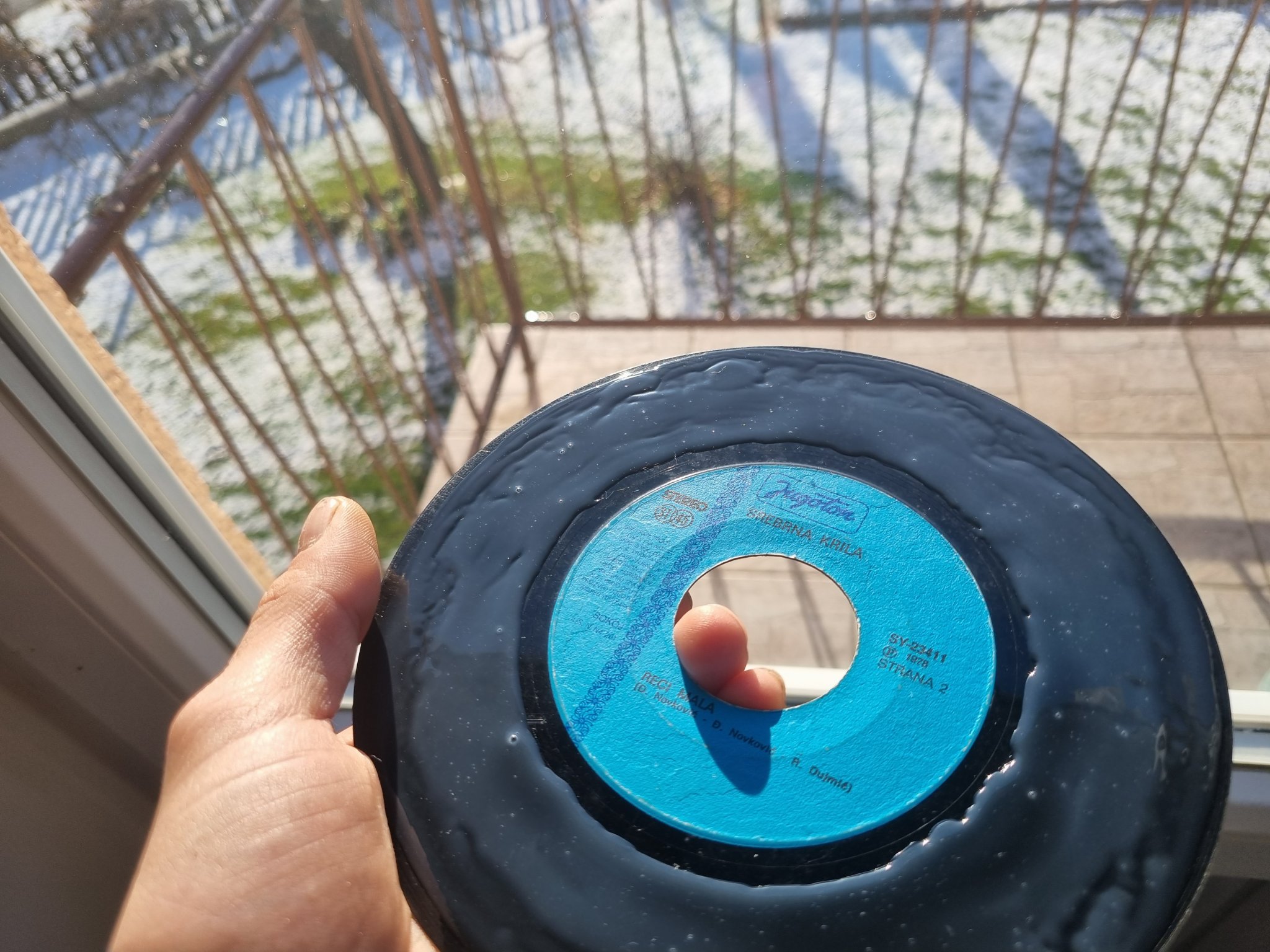

Mmm not quite ready jet.It should definitely be dry enough today, and you'll want to be somewhat cautious because there is a line between peeling it off too soon and waiting too long. The window is probably... dry enough that it's not liquid anymore, but still at least a little pliable. Waiting too long will make the glue brittle and harder to get off the record, IIRC it was around 6 hours.
Will check few times before I go to sleep.
I didn't dilute mine so I'm guessing more water equals longer dry time 🙂
This might be the reason. It's been 22°C all day in the house and humidity is actually low at 35%.I didn't dilute mine so I'm guessing more water equals longer dry time 🙂

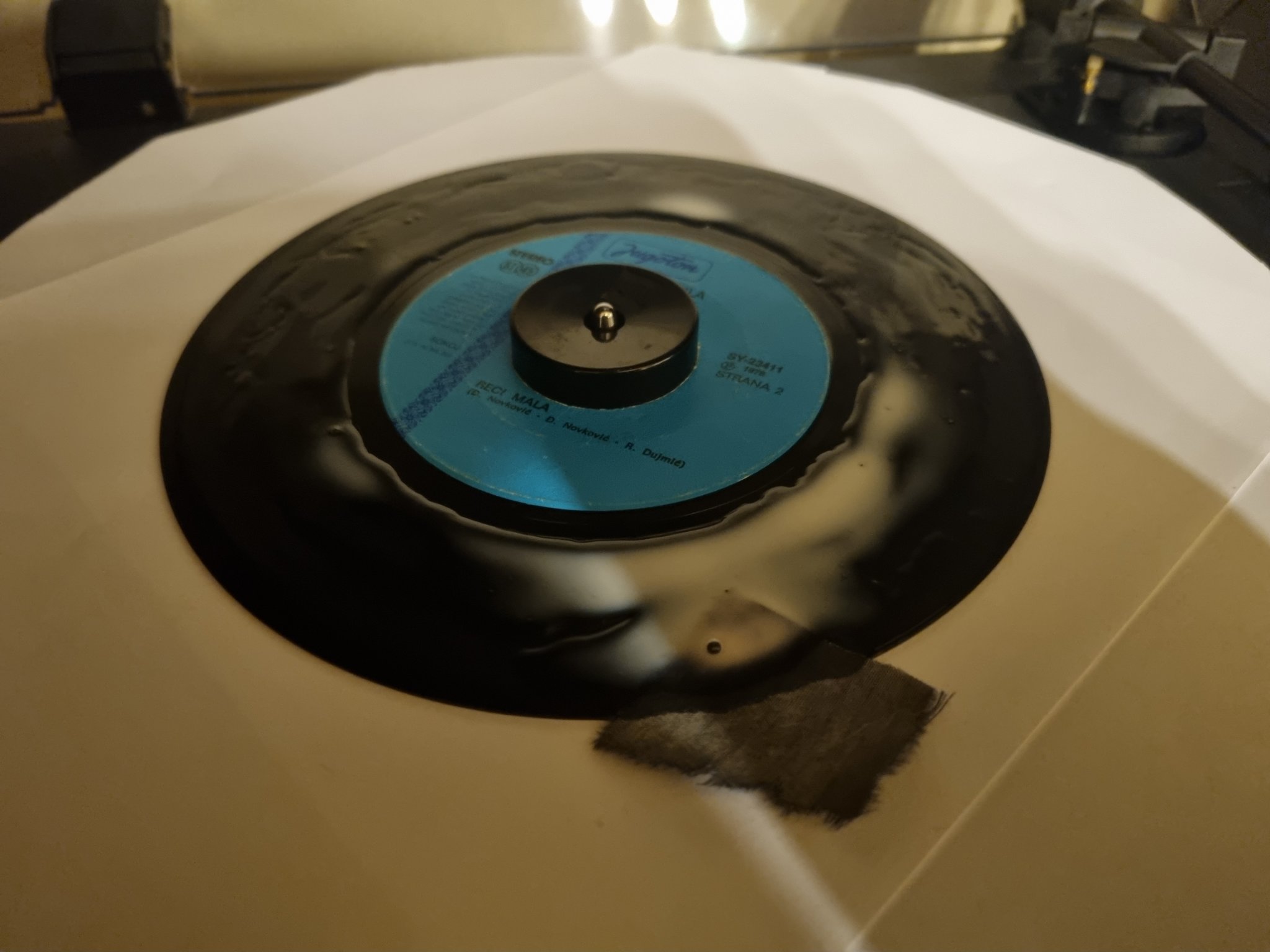

Glue is off. It was dry and it went nicely.

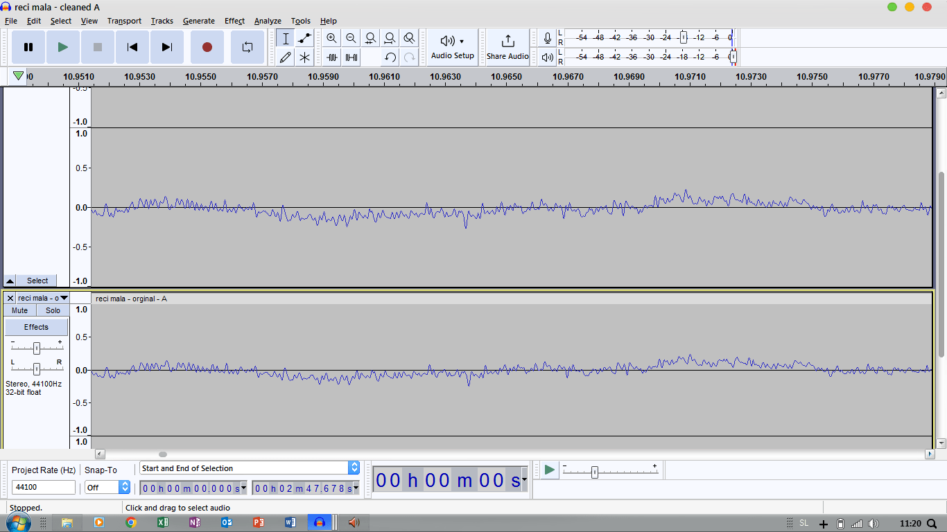

Improvement is just slight. Some surface noise is gone, alot remains because of the damage that record has.
Bigger improvement can be heard in dynamics. lt is also visible on the waveform. Look at the part from 10.9570 to 10.9650 for example.

Interesting. Yeah glue can't fix a scratch but it does work to remove imbedded grime. I think the only viable question is... Is it worth it? That answer is up to whoever wants to horse around with it.Glue is off. It was dry and it went nicely.
I would say if record isn't scratched too bad it is worth it. I will definately repeat it in the future if visual inspection wont reveal too much damage.Interesting. Yeah glue can't fix a scratch but it does work to remove imbedded grime. I think the only viable question is... Is it worth it? That answer is up to whoever wants to horse around with it.
We both came to same conclusion 🙂I would say if record isn't scratched too bad it is worth it. I will definately repeat it in the future if visual inspection wont reveal too much damage.
