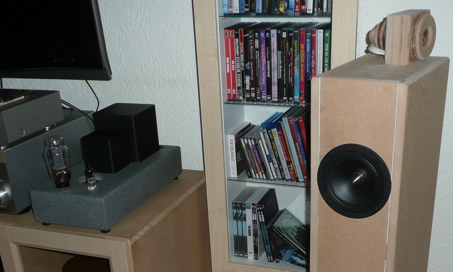

Not really expensive, but pretty good. Only because of the 3 speakers with large overlap, lobing is quit noticable. If you move your head left/right or up down, the sound changes a lot. But on the other hand, in the sweet spot they sound pretty good.
I'm considering replacing the tangbands for mark audio alpair 10's, to get rid of the supertweeter.
(the tangband are going in the enclosure Jorn proposed, but with a build in permanent rear or side firing tweet)
If I swap them for the alpairs, i'll inform you....
gr. Paul
Yes, bass and treble are both improved. Treble was almost enough. Maybe with a SS amp, it would be enough. My SE tube amp without gfb has a disadvantage there....
also the room has an influence here, I noticed a difference in performance in percieved high freq performance in my Alpair10 Conic horns depending on the room they were in, ranging from 'who needs tweeters anyway' to 'please remove the curtain'. In most rooms you'll find that the Alpair10 will perform very good, in some you might want to add a rear firing tweeter (as Paul did)
