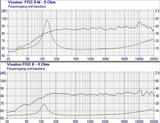

Thanks very much for the Visaton FRS8M info, I googled it and it looks VERY good, cheap and available from Soundlabs in Sydney. The 4 Ohm version (2 in series per side), looks even better? ...attached plots. The
slight peak at ~10kHz, I reckon could be easily notched out, and they would probably cost one quarter of a Tangband W4-1337SA? .. (Why does the B200 cost more than 10 times as much?)
So, .ta-da !, with much gratitude to you and Andy, it seems that I can finally decide on an el-cheapo but cheerful OB design using CW2125's and 2by FRS-4ohm or 1by FRS8M-8 . But I hope it could use an ordinary and relatively simple first order crossover. thanks mate.

pic

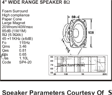

Thanks Andy,
I finally got the WES catalogue. Is your Dai-Chi the one as attached? I was very impressed with Gumby so I guess they are the same drivers there? PeteMcK likes the FRS8M (which I haven't heard), so maybe each to his own? The problem I have again with Dai-Chi is that they don't publish FR/Z plots.
I have to politely ask Russell @ StonesSS to get his test plots, because I like to try to evaluate myself....well I did say try! Ditto, for the CW2125, but at $30 I can't go wrong! Thanks.
