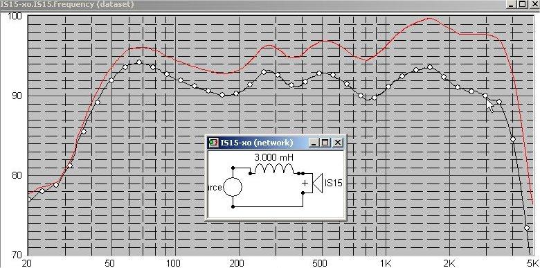

It seems that the 1225 has suitable Qts for OB, but Fs is a bit high, and vice versa for the 1525.

I read in the Eminence site that OB drivers Qts should be > 0.7 but the Manzanita's SLS830669 Qts is 0.43. The HP-15W Qts is 0.49 so maybe it is usable as PeteMcK suggested. Thanks Pete! Anyway I traced a couple of these: Red is HP15W, Black is 15PW3 and the others from other sites are SLS830669 and 27TDFC.
So, if I lose 10dB due to OB on the HP-15W , then maybe its ok for a 2way with the 27TDFC assuming all the T/S params and FR graph may be 'managed' by the crossover/ baffle placements etc?
