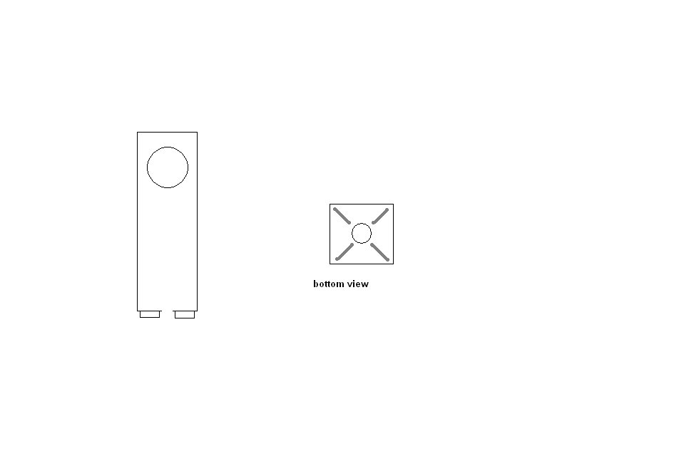

Does it mean, that I can design an BR enclosure for my AN 12" speakers, and when I finished it, to make some experiments with damping of bass reflex tube?

If you can use a BR port as acoustic valve - well, some do that, when the port doesnt work right
BUT, in reality the port area is too small to work properly as acoustic valve(aperiodic)
The BR port fore this driver will actually only be a hole without a tube - which very much resembles a MartinKing MLTL, apart from the calculations
Actually I have done similar a very long time ago - just a hole in the bottom towards the floor, and allthough it had too much bass, I simply couldnt do without it

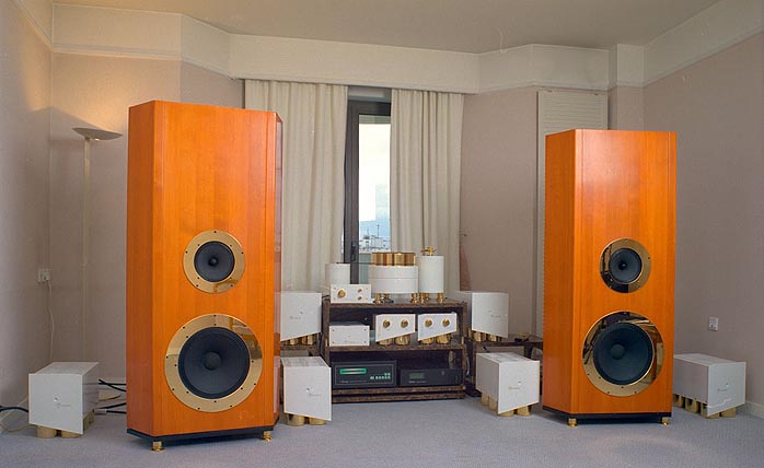

tinitus said:"notch" could look like 1mh-15ohm-1uf(maybe no cap?)
with a nice baffle
Tinitus,
Those speakers look like they have potential. Looks like 18 inch woofers there. Couldbe very high efficiency good for small SET amp.
What`s with all the weird white cabinets? Does the guy keep bees in his house?

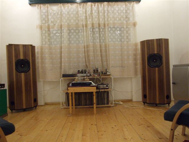

Hi folks,
...after a while, it seems that my Nirvana's are finished. Becouse I am not skillfull with words, I should put some picture, to better describe the finish of the boxes...
The inner construction is enforced and additionaly damped. Furnishing is made with natural furnish... BR holes are tuned to cca 40Hz.
Listening impressions: well, in first 150-250 hours on open panels and also, in the new BR boxes there was nothing, what I could characterised, as "pleasent" or "nice".
IMHO, I was very disappointed, and a little bit I felt, that I was a "sucker" who actually buy A Pair Of Something what produces hushy unpleasent sounds, something like "punishment-for-rookie-fullrange-ears"... But I do not give up, every time, when I left home, I switch on the music sistem, to increase the working hour period of AN"s and off course, to frightend the potentional teafs/rats/postmans... And so on, month-or-two...
It seems, there is a rule like: as bigger is the surface of loudspeker membrane, as longer is the burn-in period...?
Finally, and despite the very long burn-in period + necessary "notch filter" network (0.4mH-8.2R-3.2uF) it seems that I have at home a 240l-BR-fullrange loudspeaker with great potential, with very fast, crisp sound, wich is every day even better...!
With my DIY-fanatic friends some weeks ago we made comparation listening-tour with some FOSTEX full range speakers and I can tell You, that AN's sounds just wright! For final judgement, in next days I will compare them with Lowther DX2 in Hedlund horns, and I will inform You.
