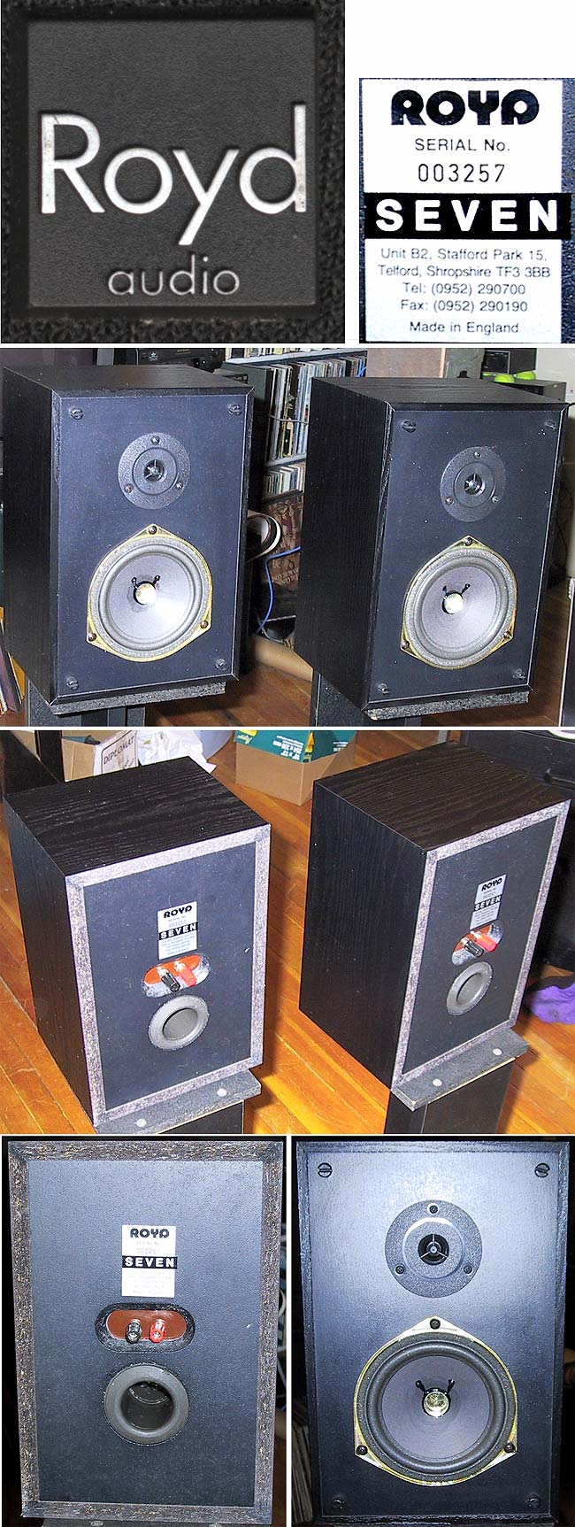

I had Royd 7, a smallish British 2-way, claim to fame, no dustcaps, single cap XO (to an audax 10mm dome*). Sounded quite decent.
*(i still have a handfullof these little tweeters on my give-away pile, i’m keepin ghte special ones with the vapor deposited metal player on the dome.)
