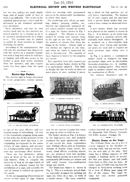

Google has old copies of "Western Electrician", which covered a lot of stuff, but I have seen animated sign contraptions in there. "Audel's Electricity" is another; also "Hawkins".
https://cmsw.mit.edu/mit2/Abstracts/Weigel.pdf (perhaps half BS, but captures the trends) (Obviously anything a fixed theater could do, a traveling show could do, especially as theaters expanded their signage and sold-off old switchers.)
Ha! I found one of the cites!
While this is a decade into the 1900s, the huge variety of designs supported imply that the technique had not been invented yesterday. In fact this is really an ad for just one company, with such a range of products that it must have been a very mature market already. What may be novel is less custom-build and more standard devices.

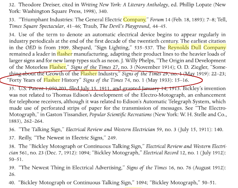

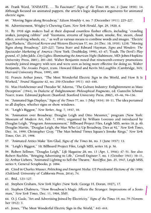

I just found some more evidence to support that. Google turned up a book, "Electric Light: An Architectural History" by Sandy Isenstadt. On page 267 of the book is a reference to an article titled "Forty Years of Flasher History" in the May 1933 issue of a publication titled "Signs of the times". (Image attached.)
So if that article was correct, and flashers had already been around for forty years in 1933, that means these electromechanical sequencers (flashers) go back to 1893.
