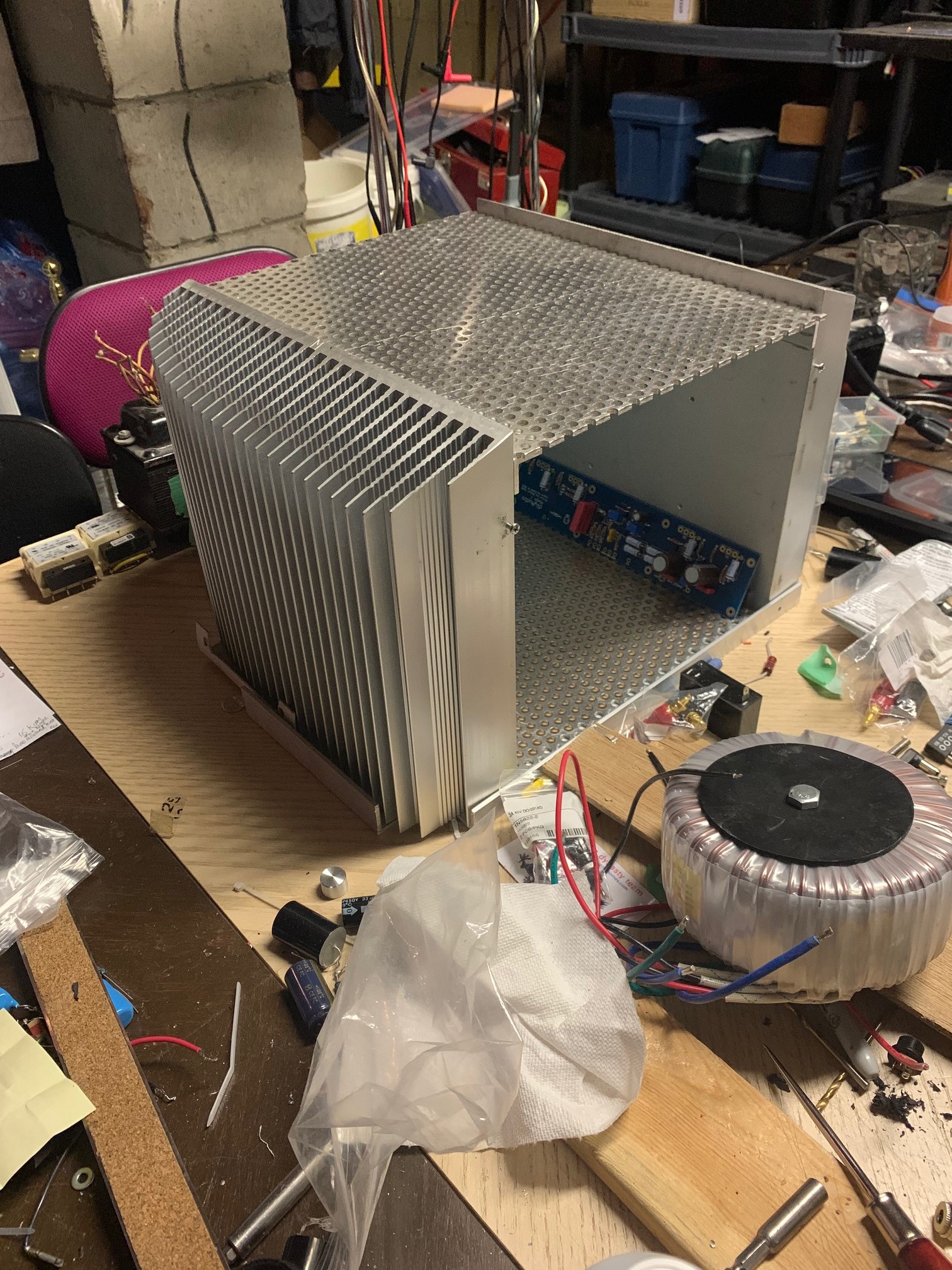

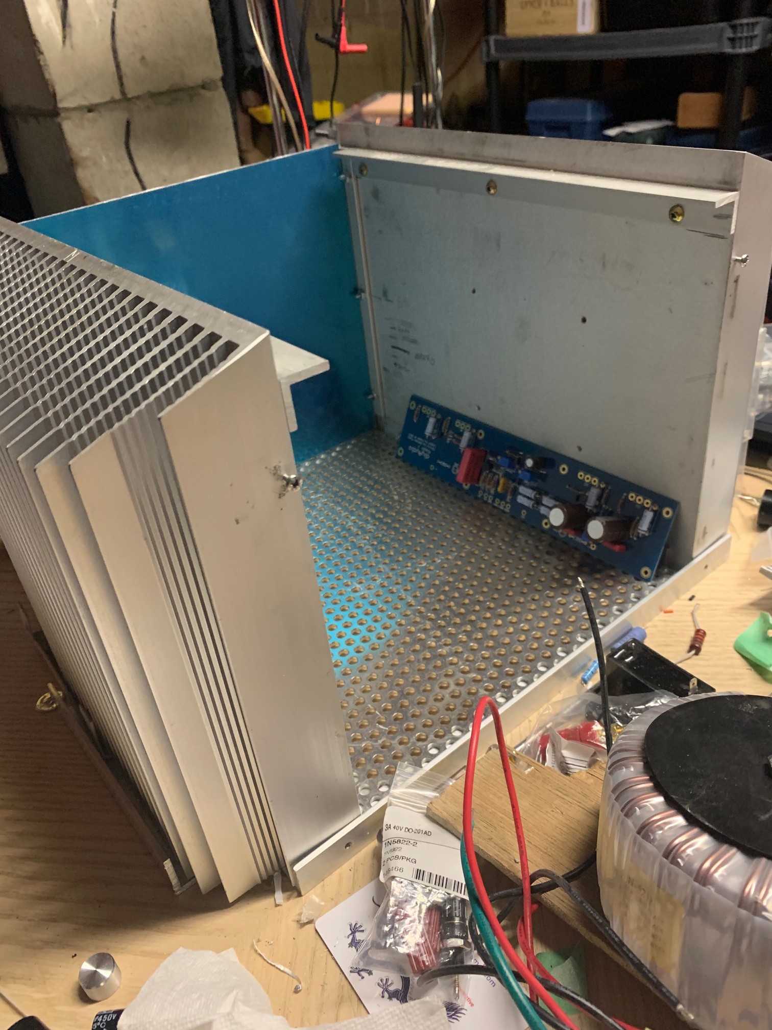

Has anyone put two different Pass amps into one chassis with one shared PSU?
One channel from each amp would be mounted onto each heat sink, with the PSU switched between each amp so that I can use either amp, one at a time.
I have very large, and very tall heat sinks, on which I can easily mount two (maybe three) Pass PCBs per side.
I figure I'm almost certainly going to build more PASS amps in the future, so why not save on buying another chassis and PSU when these two expensive elements can be shared between two (three?) amps?
I have attached a photo of the chassis minus the front plate, and one of an Aleph J board lying on the heatsink for scale.
If anyone has done this, I would love to see some photos, and hear any comments you might have.

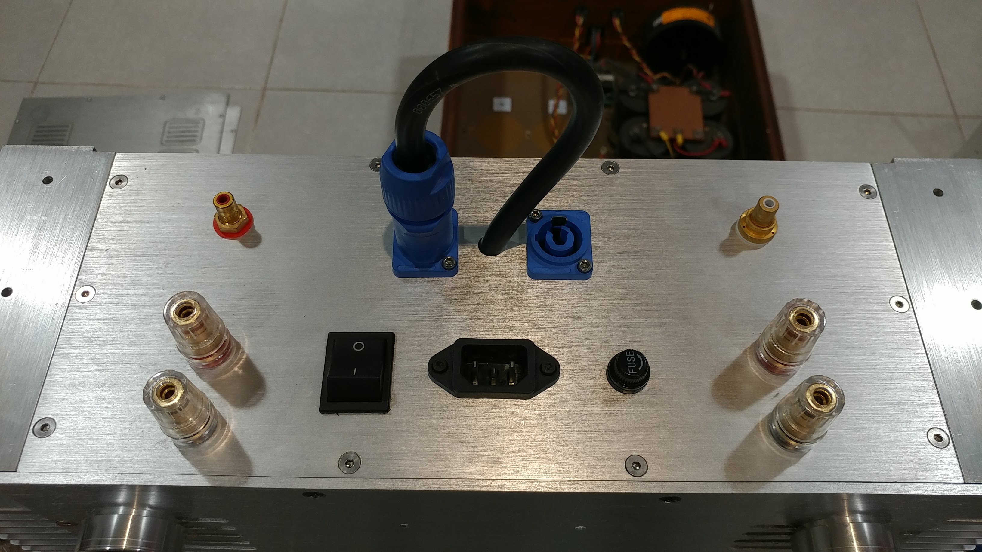

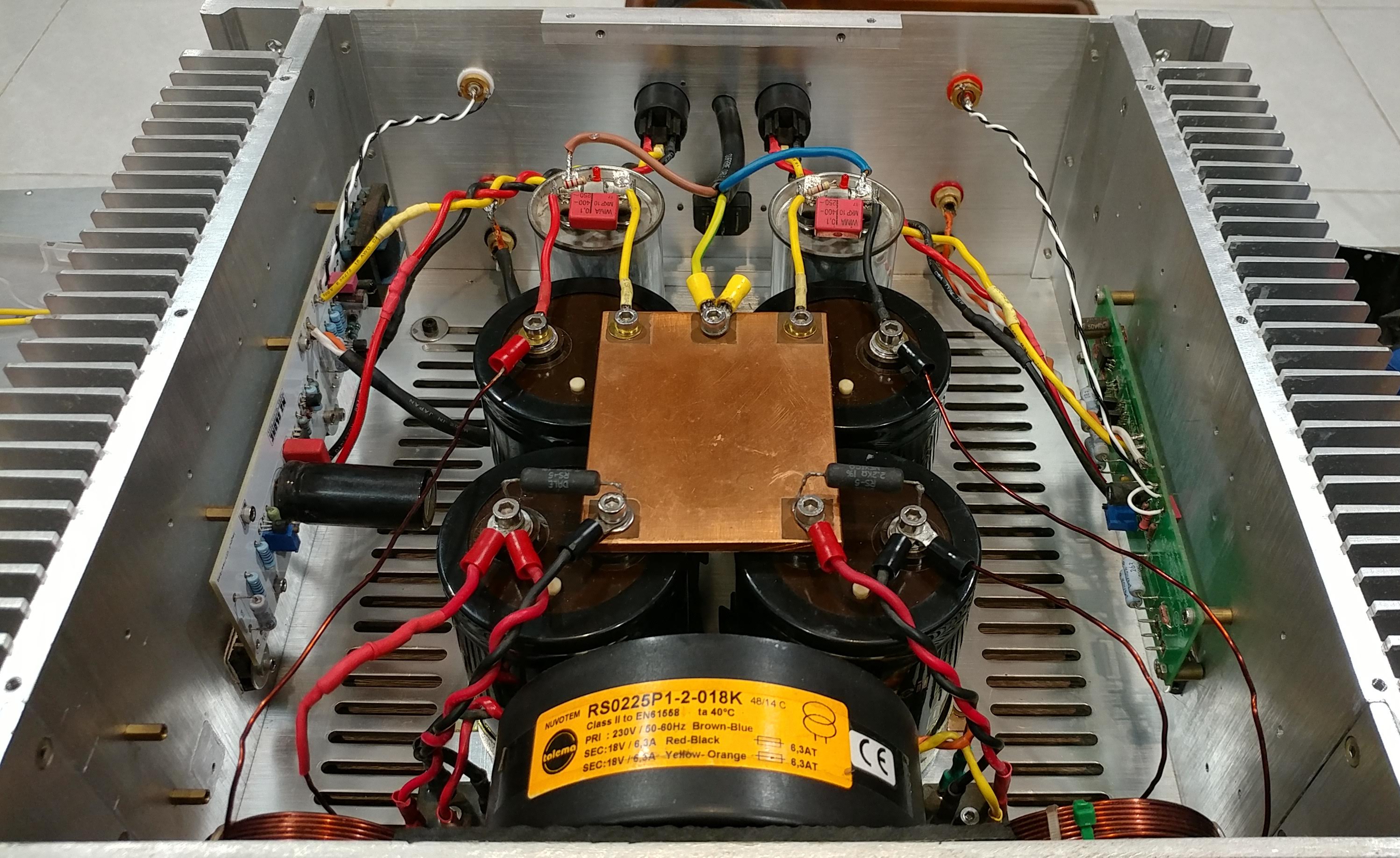

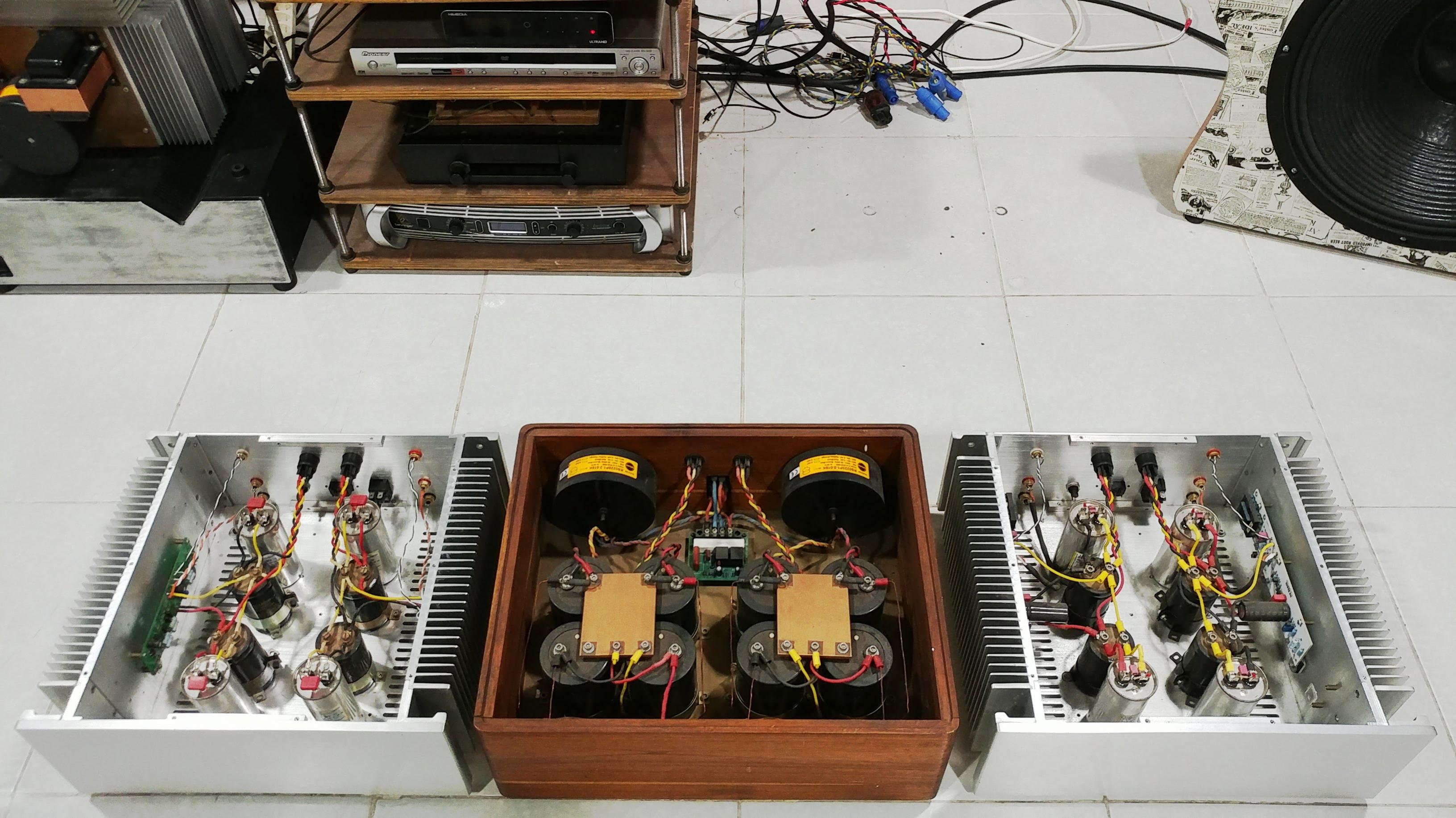

here is mine, J2 and M2. previously the psu has it's own box but then reconfigure it into monoblock. instead of using switch eventhough heavyduty, i prefer using Neutrik powercon just like PassLabs amplifier
I'm planning to build another 2 diy chassis for F7 and F2J, i have calculated powercon cable is enough length for another chassis on top of it
gadut: The separate power supply box is a good idea. A single wooden box could be tucked away somewhere or displayed. I like the idea of two PSUs in a separate box, and two (three?) amps mounted into one chassis. Using two chassis with half an amp in each is not an option in my case, as I don't think I will ever come across another pair of heat sinks like the ones in this amp. I feel like the shared chassis shouldn't be an issue, especially if there are separate power supplies for each channel.

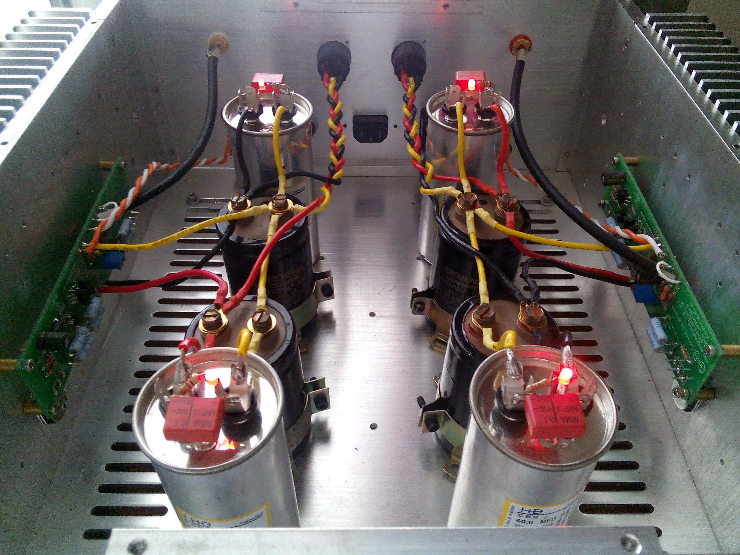

i just realize that you only have 1 chassis, but it's principle is the same as long as you have space on that chassis. however i follow UMS holes pattern which can't be used for 2 board in 1 heatsink. beside that it will be too crowded if 4 or 6 boards in 1 chassis, can't imagine the cabling if something need to be checked.
so for your purpose of using just 1 chassis, it's better to build separate psu box like i did, extra length on DC cable will act as another R on your CRC or CLC supply. only need to make sure to add capacitor on amplifier chassis as final filter
here is my previous amplifier layout with 1.2m dc cable
black one is 15.000uf and metal can is motor run 60uF which is connected in paralel. considered it as just one C on final supply filter. this is considered as low value on my supply, because main capacitor is 68.000uf
