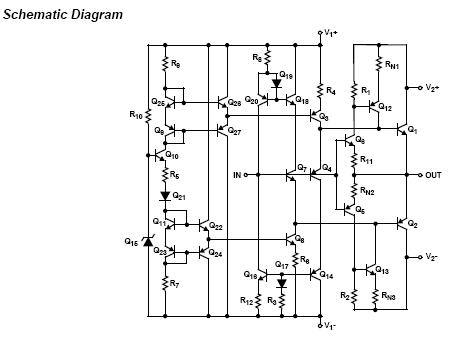

Anyone played around with this HA-5002 current buffer?
I don't mean to ask a dumb question, but here goes: what are V1 and V2? Two separate rails for what? The datasheet is not forthcoming to me.
I used to use the LH0002 to buffer opamps, including them in the feedback loop. It worked pretty well and that took care of the offset. I'd think that with a unity gain stable opamp with reasonable-not-insane bandwidth, you could do it with this chip, too.
Save me a Goggle- what's the cost on these? Cheap (I hope)?
Hi SY, the link is working, it's a 800k PDF download, the HA-5002 is all by it's lonesome, there is no feedback to include it into, and the separate rails are for it.
If you see the PDF you will find a schematic of what's inside, about half way down, you see it's like a mini poweramp with separtate rails, input/driver have separate + - rails pins V1+ & V1- and the output stage also has separate + - rails V2+ & V2-
