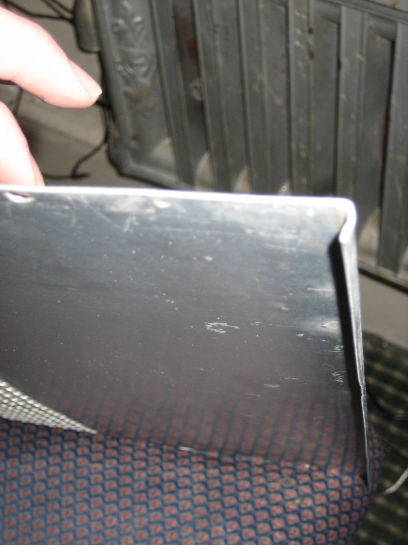

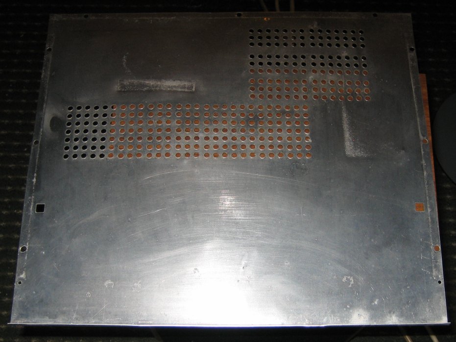

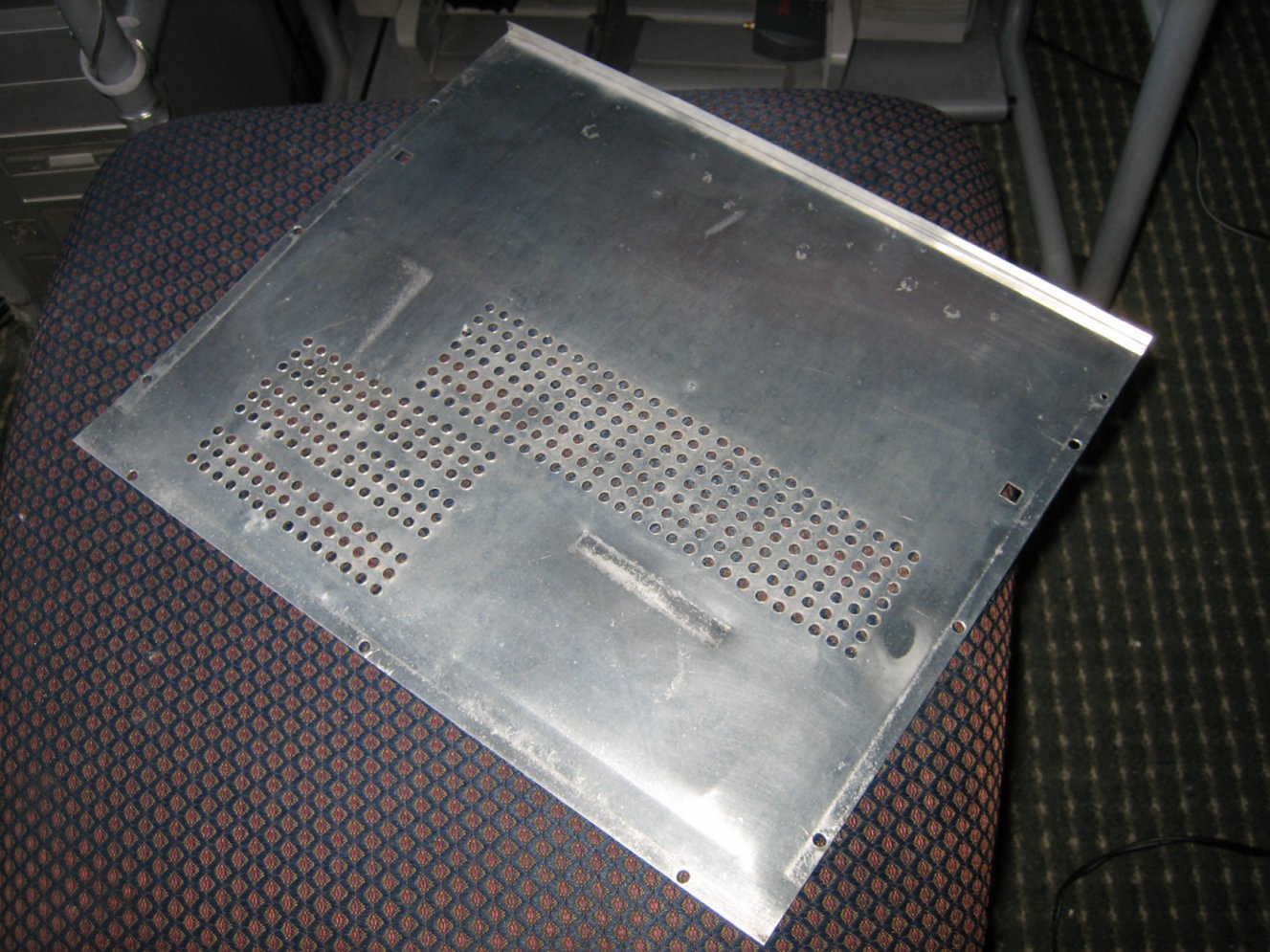

I picked up a LK-72 recently, fixed some power supply issues and recapped it and I am very happy with the results. I am in the process of fabricating a bottom chassis cover plate as mine came to me without one. Problem is I have never seen one and have no clue as to the layout of the ventilation holes. I was hoping that someone might post a photo or a drawing of the layout. Also I notice that their are no screws in the front side of the chassis for the cover plate. Is there an air gap in front between the cover plate and the chassis?

I've previously owned one, but it was sold a while ago. If building from scratch, I'd just put some holes underneath the power supply area and the strip of power tubes. The panel had a 90-degree bend on the front end, with about a 0.5" lip, which slid into the slides right behind the front panel. This kept it rigid enough not to need screws there.

Yes. I like the idea of the 1/2" break. That will take some of the bow out of the front panel and make it more rigid. I'll drill a pair of 1/4" holes midway between each power tube and a matrix of six under the power supply resistors. That ought to do it.

I would double that at a minimum. I have had a lot of Scott amps and still have a 299. The more air you allow to circulate in the chassis the better - they run rather warm.
Do NOT leave your amp running unattended for long periods of time either, and make sure it is really well ventilated. Back when I had the business and was servicing a lot of vintage Scott gear some people thought it would be a very smart idea to leave their amps running continuously - in almost all cases this resulted in pretty rapid failure of the power transformer. (A few weeks at most) I must have seen at least 3 or 4 amps that failed this way in a short period of time.

I took several pictures for you of the 299C bottom plate. I hope this is helpful.
