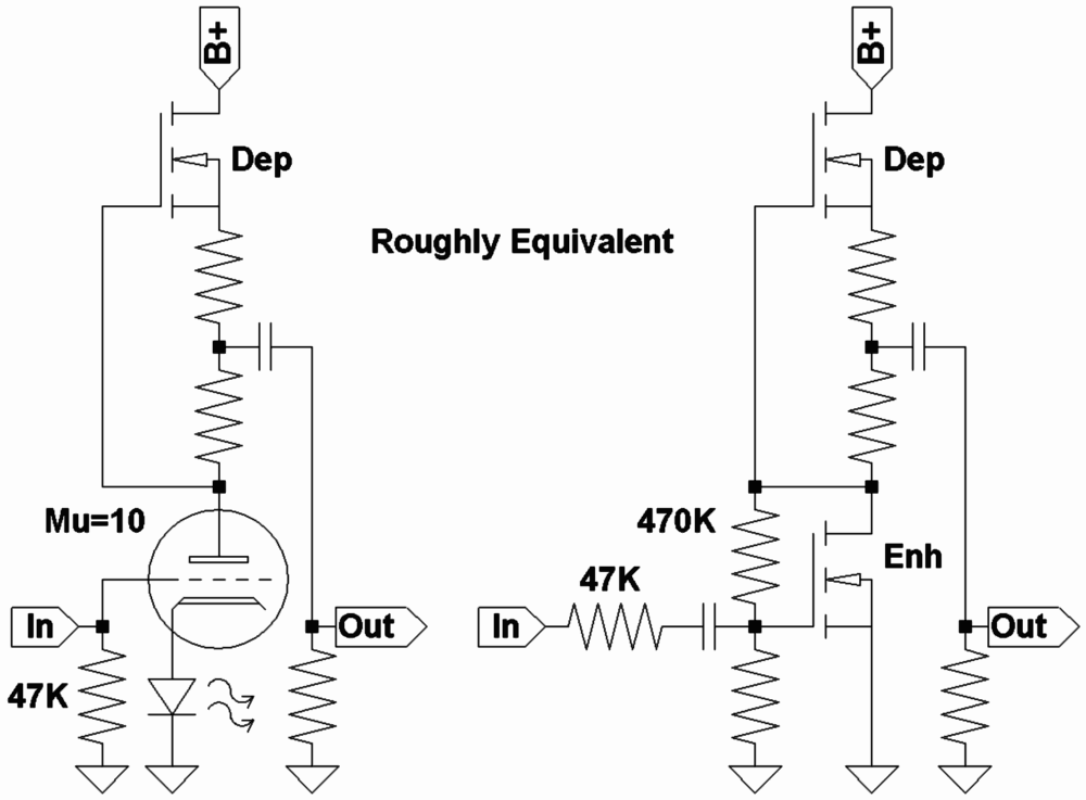

So if you are not using a tube or depletion device on top can it be done somewhat simply with enhancement mode devices? Also is there a way to calculate the resistor spit, or just trial and error? Feel free too at anytime to just tell me to search 😀 , I can do that at the same and try to answer some things on my own.
This is still kind of on topic but I don't know if I am kind of thread jacking
"So if you are not using a tube or depletion device on top can it be done somewhat simply with enhancement mode devices? Also is there a way to calculate the resistor spit, or just trial and error?"
Well, the diagram linked in post 19 above shows it with an enhancement Mosfet. Which required a bunch of LEDs to bias the gate voltage up. A depletion mode device could eliminate this DC offset issue.
Nominally, or ideally, the output (current sense) resistor(s) (bottom dev. plate to top device source) gets center tapped for output if the top device has much higher gm than the bottom device. So a Mosfet comes close to the 50/50 tapping for most tubes on the bottom. But keep in mind that the gm of a Mosfet varies approximately linearly with current, and they are spec'd at ampere currents typically. So in the tube circuit its gm is not so huge, but still usually 10x ballpark more than the tube.
To get 1st order improvement, assume some delta I current variation from the tube plate. Then calculate how much gate voltage variation is required on the Mosfet (at its reduced spec gm) to reduce it's current by the same amount. Now just add enough resistance to the bottom section of the split resistor so that it generates that additional voltage with the initial delta I variation.
The total resistance of the sense resistors and the Mosfet or depl. mode voltage offset set the idle current for the stage by setting the operating bias of the FET with some voltage across the sense resistors.
In general, the scheme relies on the top device having considerably more gm than the bottom device, in order to get close to SE signature. So a tube on top is not likely to cut it without an additional diffl. stage acting as an Op Amp up there.

So If we anode load a low mu triode with a Mosfet CCS and arrange B+ and Iccs so to get B+/2 at anode, we essentially get an anti triode?
The anti-triode uses the two resistors tapped to the output node to sense the currents in the top and bottom devices. A constant voltage is ideally maintained across the two resistors (for infinite gm on top) when I(bot) + I(top) = constant. The voltage drop across the top FET does not need to be half the B+. They can generally operate with less than that. But too low a voltage across the FET will get one into non-linear capacitance problems from the FET. Best to keep the FET with at least 50V across it mimimum (ie. at output signal positive peaks).

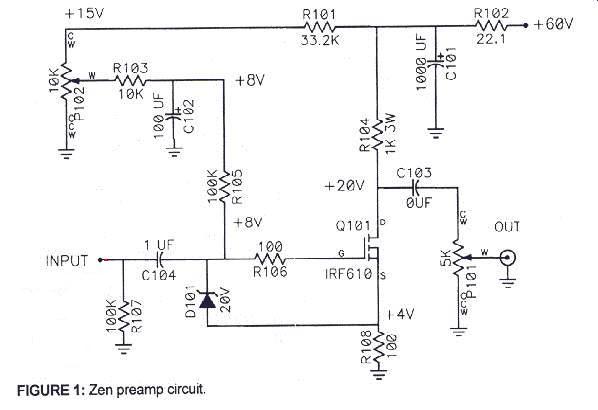

You can't stick Aleph or Anti-Triode blindly on top the MOSFET
of post #1, as it is a current amplifier with no voltage control.
No control aside from the 10K load. You can't substitute any
CSS (Aleph or not) here for the 10K, unless you first implement
some other means of controlling the resulting voltage swing.

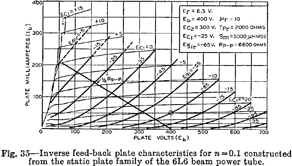

By Schading (since someone requested I speak in English)
I mean using an Anode follower, or other partial feedback
to transform Pentode (or MOSFET) curves into a Triode.
The original idea, as proposed by O.H. Schade long ago.
