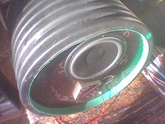

pic
Here is a pic of my 30W100XL testing enclosure. Sure it looks like s**t, but anyway it sounds surprisingly good
The final version propably has end caps made of 25mm MDF (currently 20mm veneer). But I'm still wondering how should I finish that surface to make it look acceptable for living-room.
Also, placement of amp+xo+stuff in a sub-enclosure confuses me a bit...maybe I should put one dividing wall (25mm MDF) in the tube, to separate the electronics from the woofer's air flow?
Currently, building the sub amp and cross-over keeps me busy for some time. I hope I'll get it working well. 🙂
