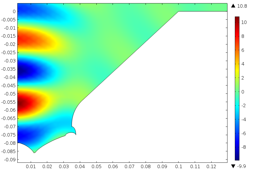

Since a 3.5" fullrange driver differs quite significantly from other things you usually put in a waveguide I'm guessing that there needs to be a lot of trial and error with prototypes to get rid of peaks and dips. Or, as my approach usually is, trying to simulate the response.

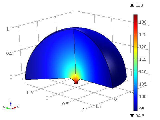

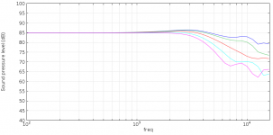

I started with measuring the TC9 with calipers and making a FEM model. First a sim of it being mounted (countersunk) on an infinite baffle:
Compared to data in datasheet:
First cone resonance at 9 kHz I'm guessing when comparing to simulated response (pistonic).

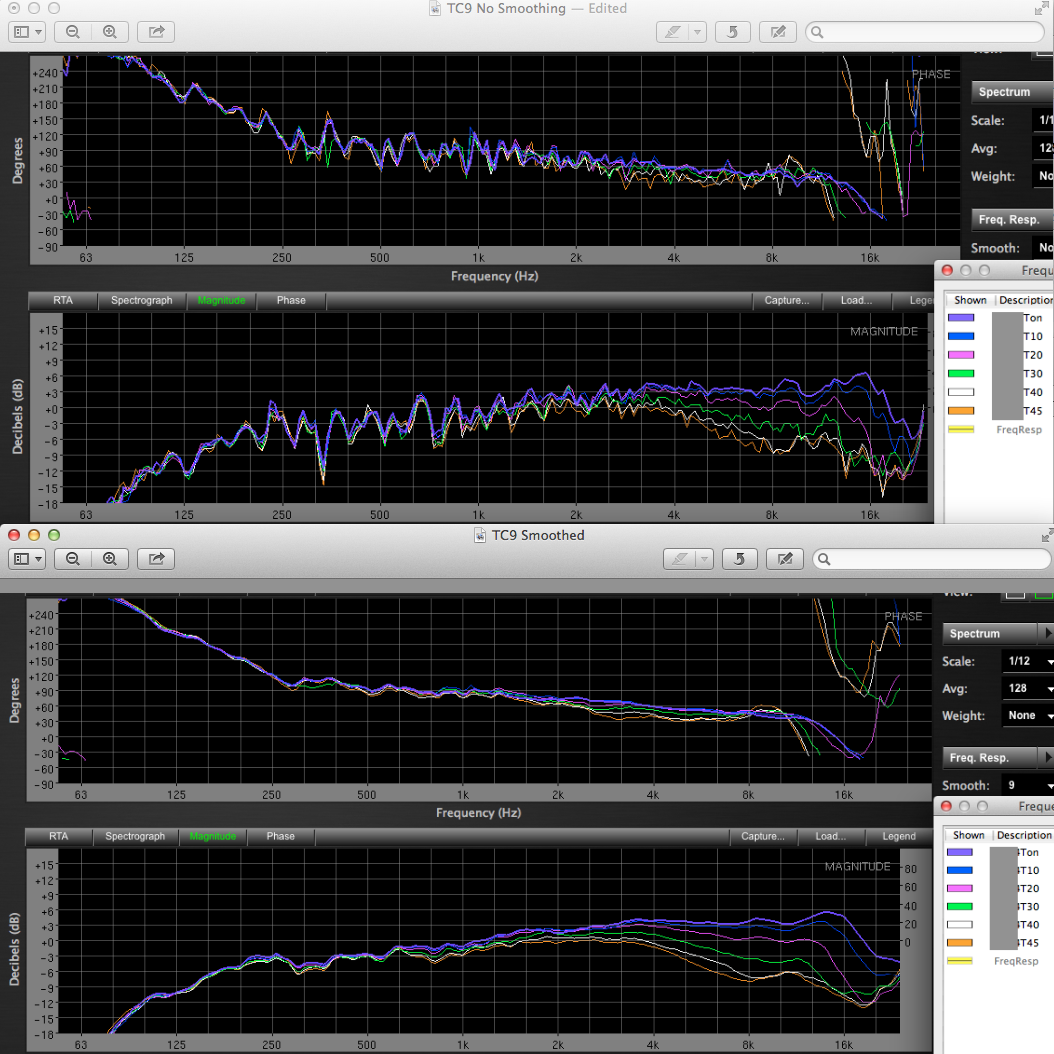

Here is Weltersys polars for the TC9:
The directional behavior is overall correctly predicted by the simulation.

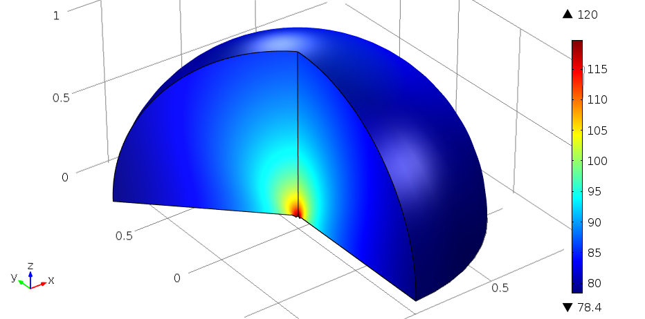

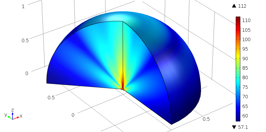

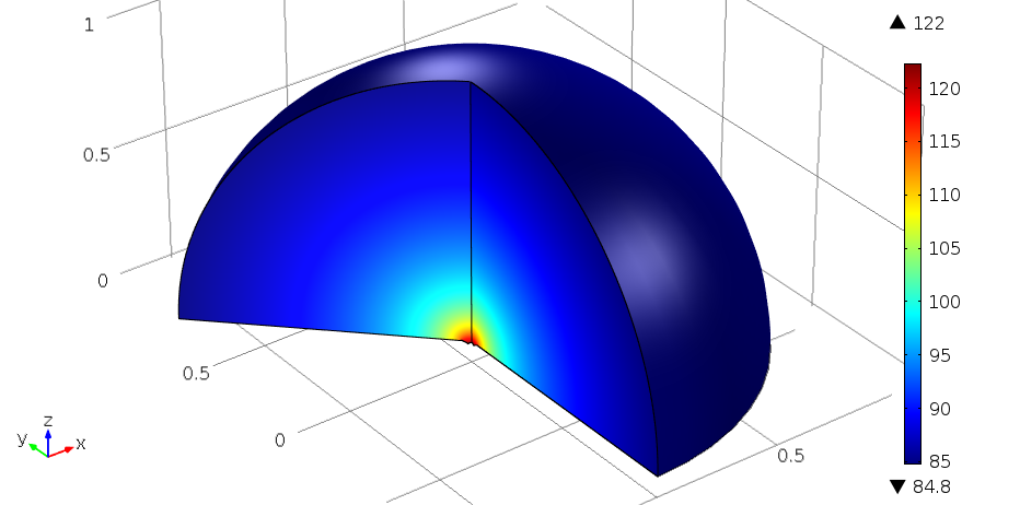

Here is SPL for the first 1 m at 1 kHz:
Monopole behavior.

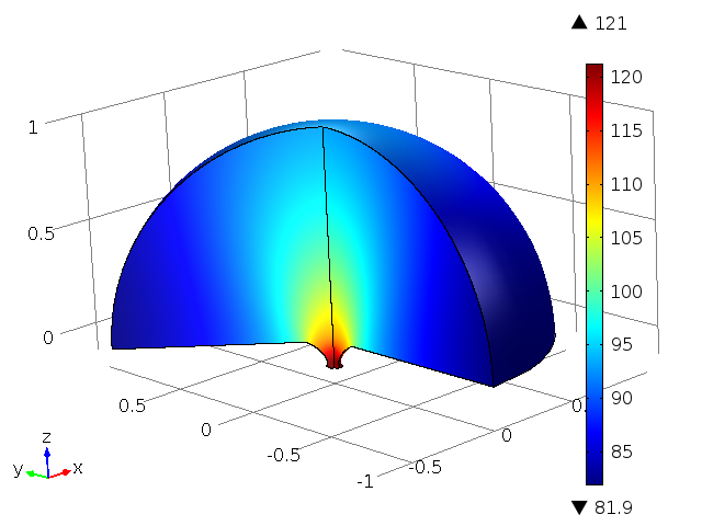

At 4 kHz:
Starting to beam slightly.

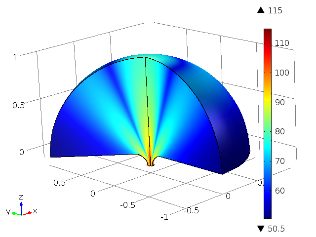

At 8 kHz:
More beaming and slight lobing.

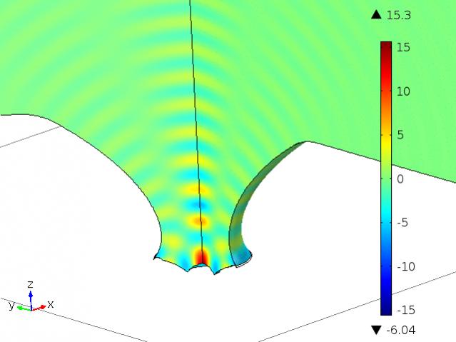

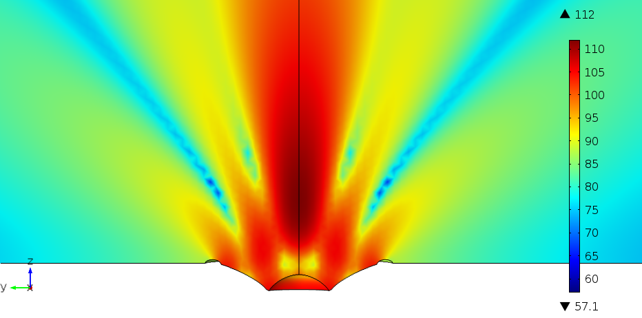

At 16 kHz:
Beaming and lobing. Here is a close-up:
You can se the shape of the cone.
I'm assuming pistonic motion (constant acceleration, linearly declining over surround).
I've started iterating a little to see what kind of waveguide could suit this driver. A question: is the cone of the 10F identical in shape? I'm guessing it is better suited for loading in a waveguide since the cone should be significantly stiffer with the added fiberglass.

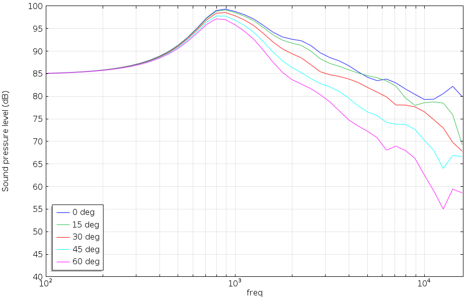

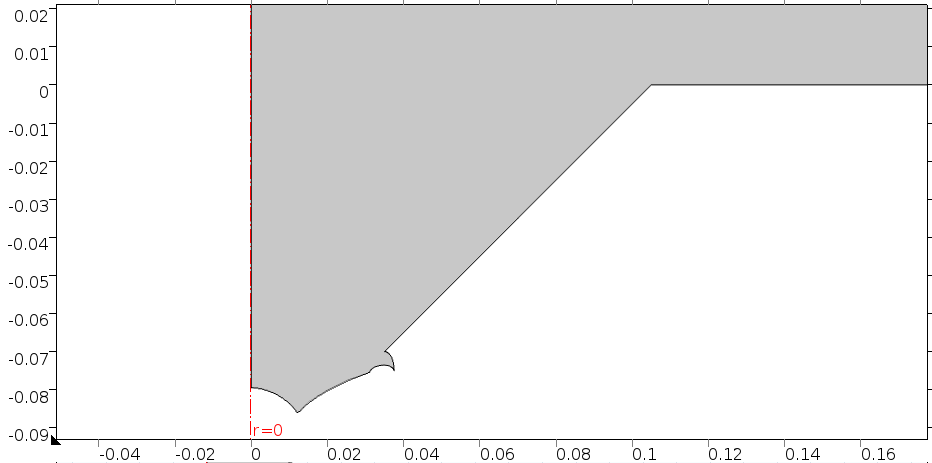

Let's start with a few iterations (all 7.5 cm deep):

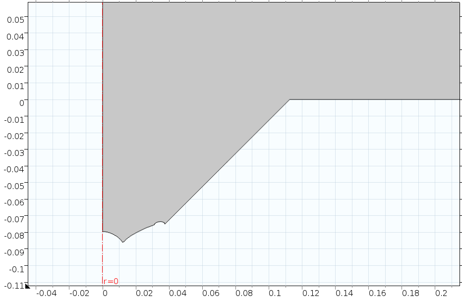

Iteration 1 - How about a simple conical that fits around the surround
Easiest to make. Here a 90 degree WG:
Response:
Quite decent 30-60 deg, but not so much 0-15 deg.
How about a 120 degree WG:
Response:
Nah, not better.

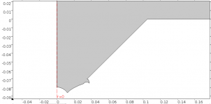

Iteration 2 - Conical above the surround
Alright, so let's follow xrks advice about starting the WG at top of surround (with a distance of 3.5 mm for excursion). The throat is 70 mm diameter.
Response:
Not really better than the 90 degree above.
Iteration 3 - Added initial roundover
Response:
That's a little better, decreased the on-axis dip 🙂 The radius is 2 cm.

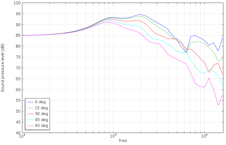

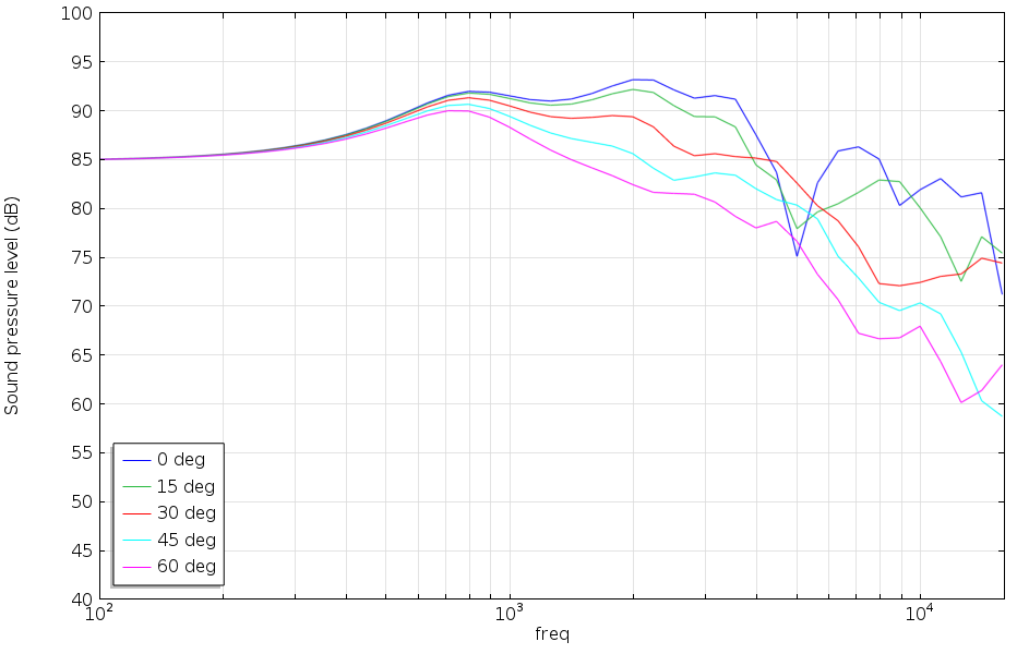

Here are some more results for the TC9:

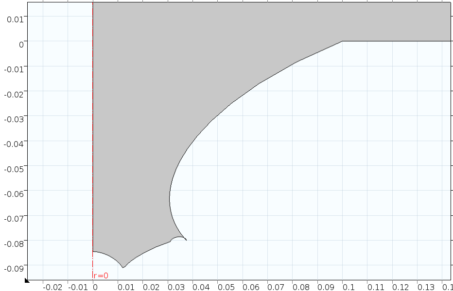

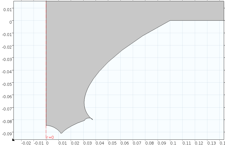

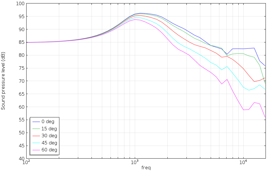

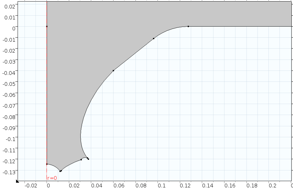

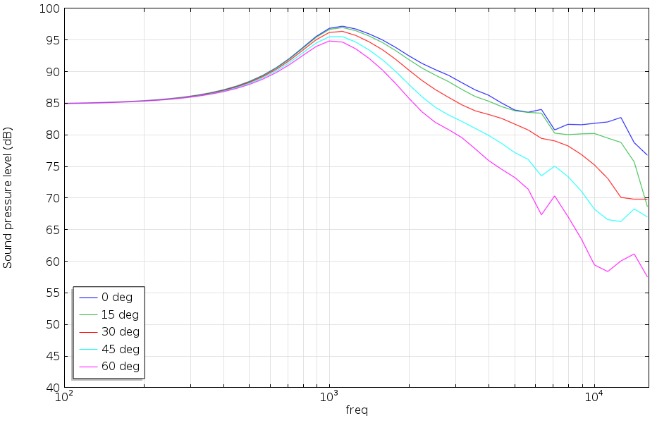

Iteration 4
I tried going for the smoothest possible profile, so it starts around the surround and is a quadratic curve (2nd degree). There is a guide point 40 mm from the driver bezel and on the centerline.
Quite smooth! Not very constant directivity though. More like a tractrix maybe?
Iteration 5 - more conical
Let's try moving the guide point down slightly (10 mm) to get a more conical profile (and hopefully more constant directivity).
Now that's not so bad 🙂
Note: The downward tilt is exaggerated by assuming a pistonic motion with constant acceleration. As the waveguide causes the driver to couple better to the air it will cause the moving mass to increase and therefore the acceleration.
/Anton

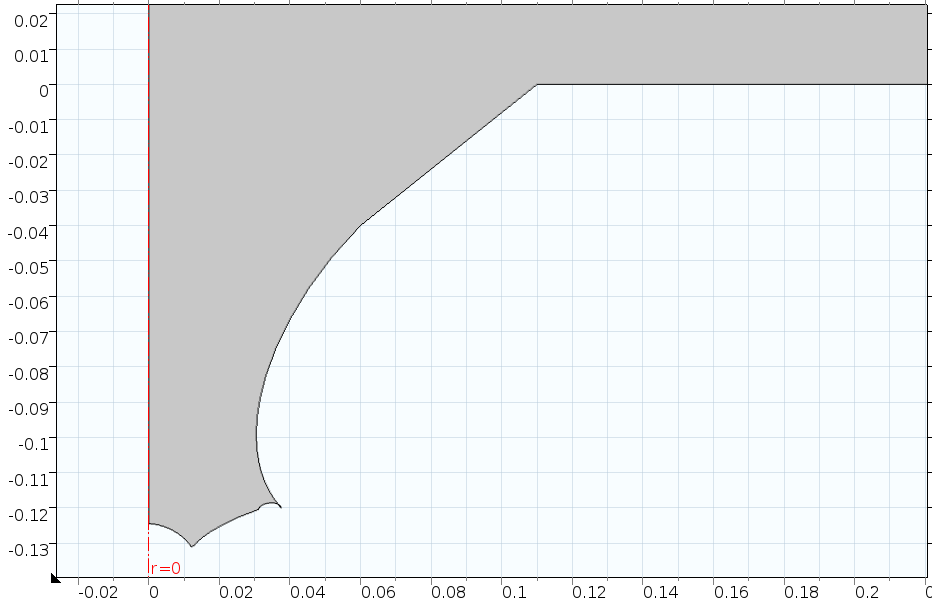

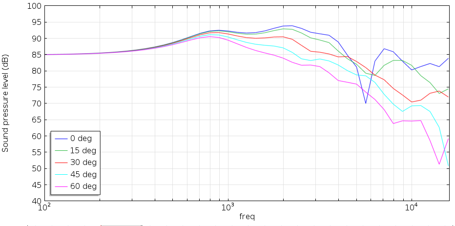

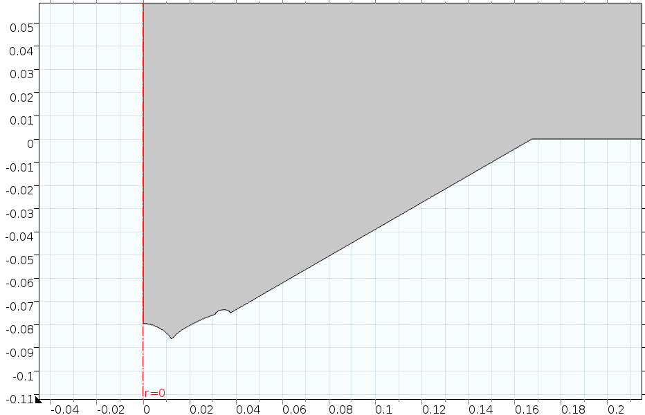

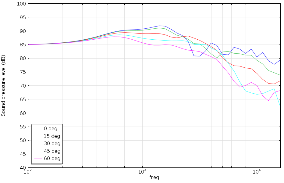

Iteration 6
A slightly deeper WG (12 cm).
This is IMO decent. I might test this geometry... I'll try a few more iterations to see if I can get the on-axis response a little smoother (dip at 5.5 kHz), but off axis is already acceptable.
If I add a 50 mm fillet (roundover) at the mouth I get this:
Overall a little smoother, but no huge difference.
/Anton

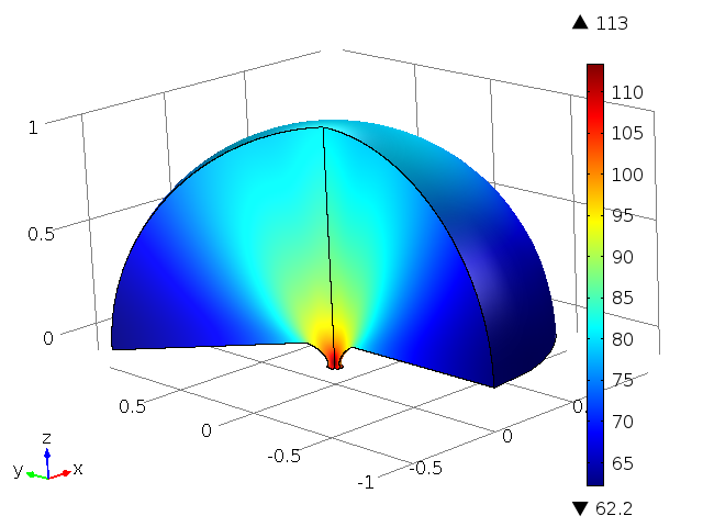

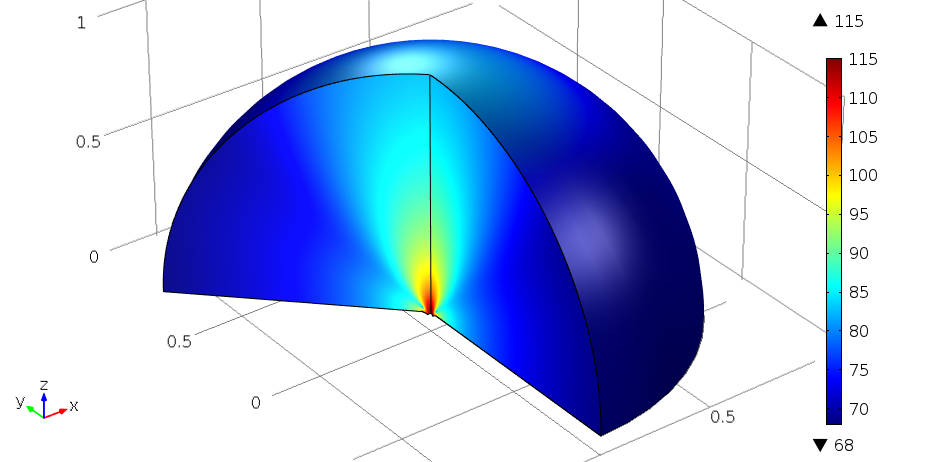

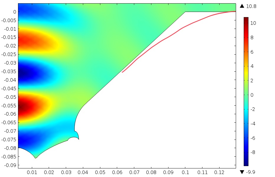

A few more figures for the last WG:
SPL at 1 kHz:
Slightly directional.
At 2 kHz:
Distincly directional.
At 4 kHz:
At 8 kHz:
Still no lobing.
At 16 kHz:
Lobing, but smoother than mounted on flat baffle (compare to post 4).

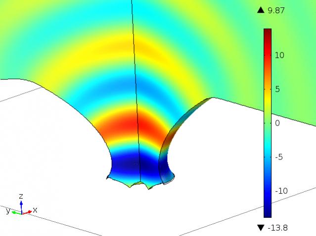

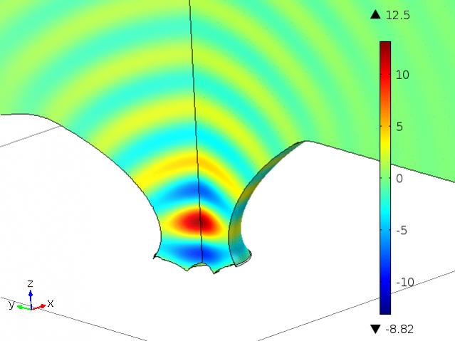

Animation of pressure distribution at 4 kHz:
And at 8 kHz:
Smooth.
At 16 kHz:
Lobing present (0 pressure along line).
EDIT: I can't get the animations to play :/
/Anton
