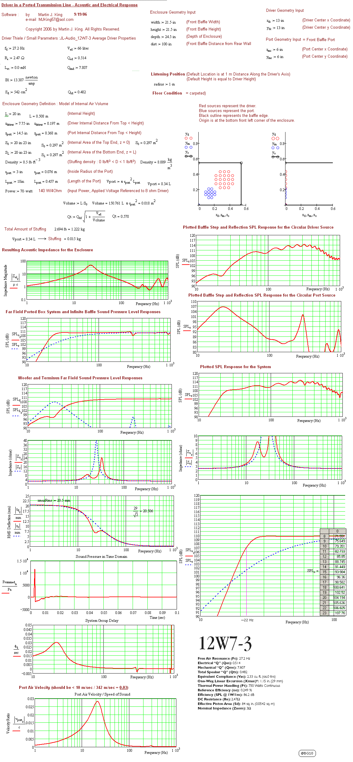

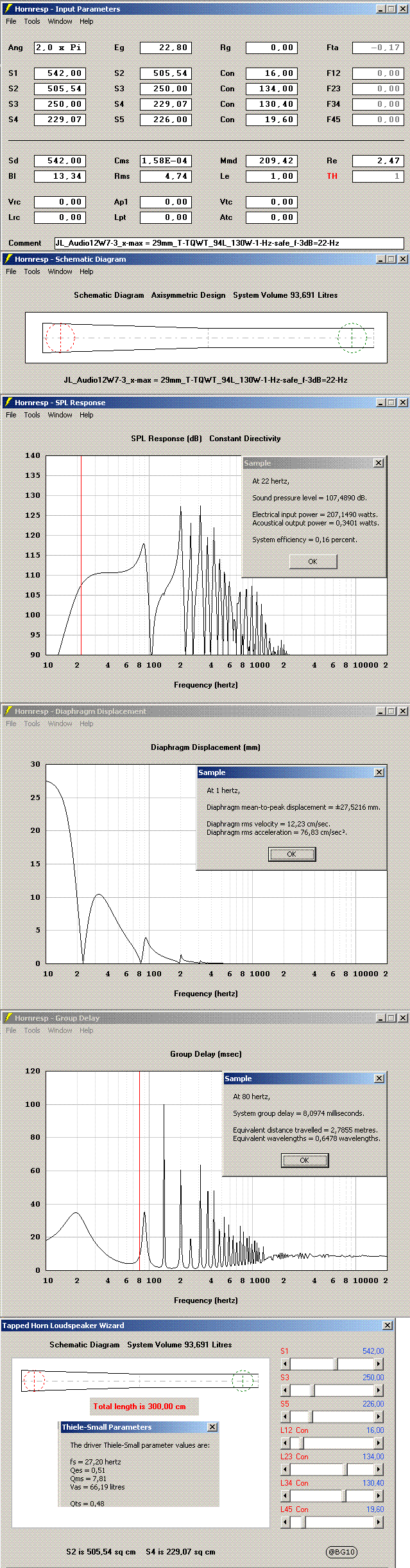

Hmm, a 4.5 ft^3 tuned to 21.5 Hz requires a TL size vent to handle a high Xmax 12" at high power (> 6" dia. in area), so if you're not using PRs, then figure you'll lose up to 6 dB down low in vent compression plus VC heating could rise enough to make it audibly under-damped even without any room gain, potentially making it a boom-box in-room on some recordings.
GM
GM

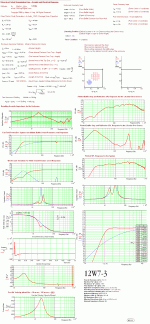

Agree with Greg, See the simulation of a JLAudio12W7-3 in an aperiodic ported 5.33 cu.ft box where the port diameter is 6" at a 1 Hz x-max safe SPL.
The excursion is almost hitting the maximum recommended limit, even with a stuffed port.
As usual :) I prefer a T-TQWT solution where the box volume is brought down to about 3.32 cu.ft and no aperiodic behavior is needed to tame this driver.
b
