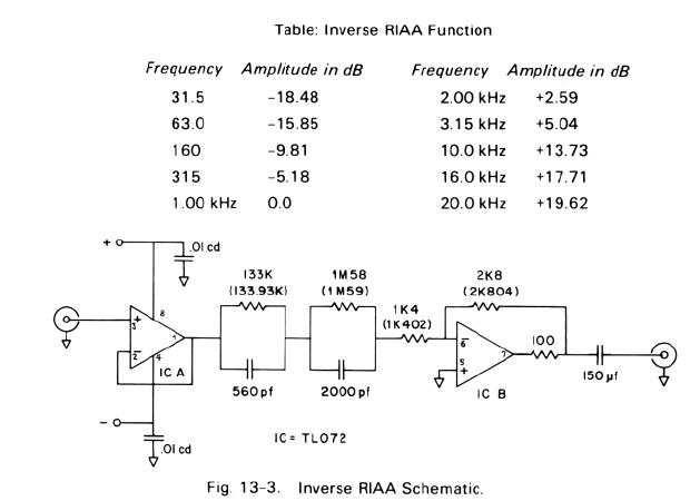

many thanks mlloyd, this will be an interesting read especially since this will be my first foray into the RIAA world. i plan to fab a board/circuit with the exact same dimensions as the ond one so its a drop in replacement.
