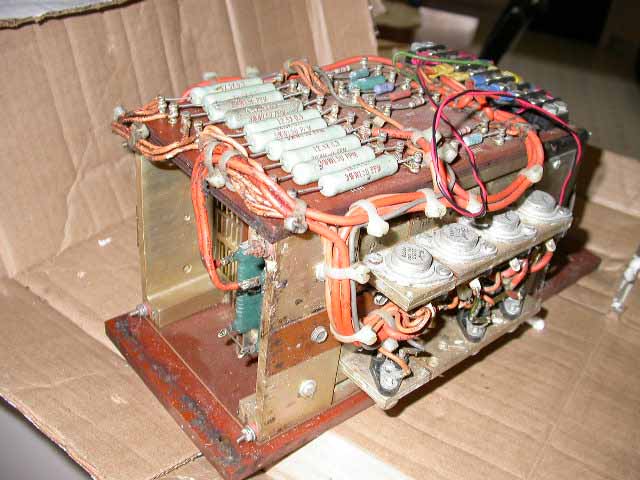

jackinnj said:those are SCR heatsinks --
SCR as in Silicon Controlled Rect or something else?
the Trannies are regular BJT's 2n3772 etc.
I wonder.
Jack speaks Dutch, maybe he meant something in that crummy language.
Or just the manufacturer, he is not always in a funny mood i think.
My big bro lives in the NJ/NY area.... very irritable guy... I told him to move to the calmer pastures of the Midwest... but nooooo. 😀
OK now please help me on this, anyone know what these trannies are? They seem like dual die BJT's from Sanken. They were in a class-G power amp with +/-92vdc rails. They have the following pin out.
E1-B1-C-B2-E2 (collector is common). They are MT200 pack and made by Sanken.
I need to know the specs on these.

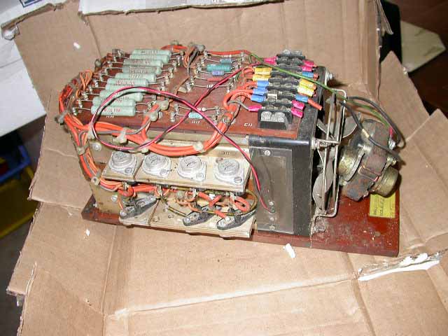

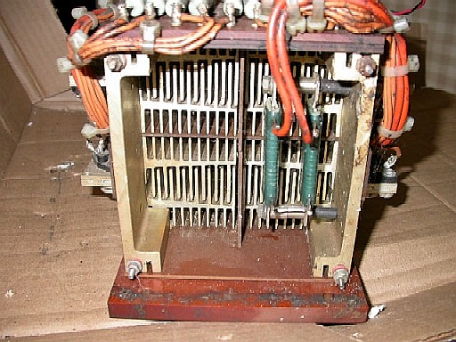

I would say that that wind tunnel heatsink module would be either an industrial motor controller/driver of some sort, or a series pass linear regulator assembly for some ancient mainframe computer (with less computing power than a wristwatch). trace out the circuit....
- Anyone know what these were?
