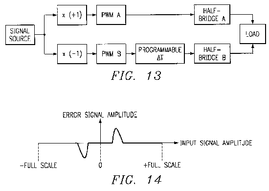

Hi John,
Originally I was thinking about 6-8phases and that still needs 30 chips. I came to 12phases only because TAS5076 provides them.
Regarding multiphase approach here is an article that originated my design. Here is a patent application that further convinced me about validity of my project.
Thanks for your opinion, I think I will ditch multiple TAS5015 idea. VHC164 approach is still in consideration, but maybe it would be better to put it to the power stage.

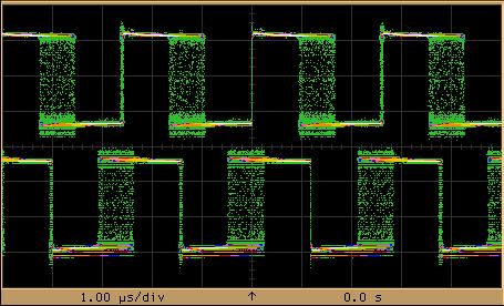

I'm not sure what you mean by ABD delay. However, the TAS5015 seems to have BD outputs - where the B channel PWM output is a 180Deg phase shift copy of the A channel (so delayed by 128 MCLK cycles). As opposed to AD modulation, where the B channel is a simple phase inversion of the A channel.
Below is a scope shoot of the TAS5015 A and B channels. The scope is triggered on Ach, the resultant "BD" modulation can be seen on the edges.

Jaka Racman said:I am currently designing modulator board with two TAS5076 modulators. ABD delay parameter is indeed intended for distortion reduction but it's function is to actually delay one leg of half bridge in respect to the the other leg of the same full bridge. In this way simultaneous switching of both legs at around 50% duty cycle (low amplitude signal) is avoided with detrimental crosstalk effects. This is clearly depicted in attached picture from patent application US20020060605.
Yes,
I now realize that I was confusing the ABD delay (in the modulator) with the dead time adjustment set by resistors to BIAS-A and BIAS-B in TI's output chips (DTC_HS and DTC_LS on the TAS5182).
The TAS5015 and TAS5012 have the ABD delay fixed, with no adjustment possible.
Another thought that pops to mind is that it might be beneficial to use pots for the deadtime adjustment (at least initially) to tweak for minimum distortion.
Brian.
