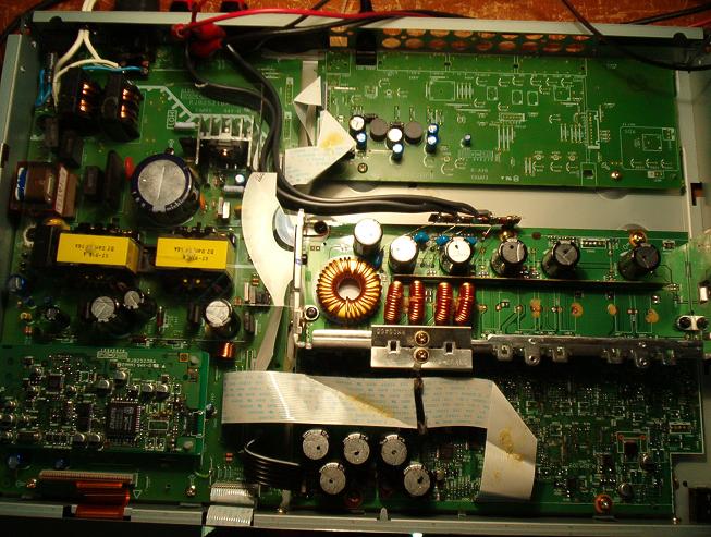

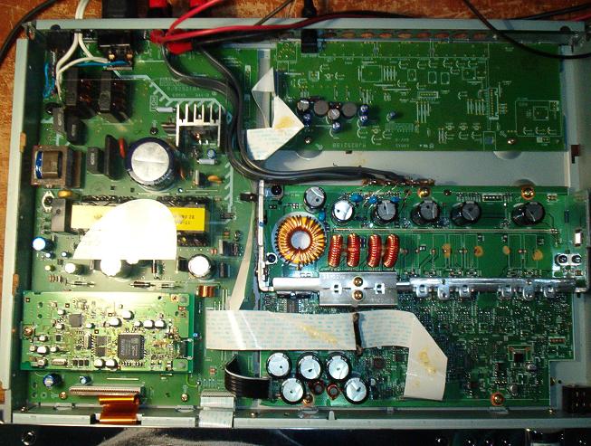

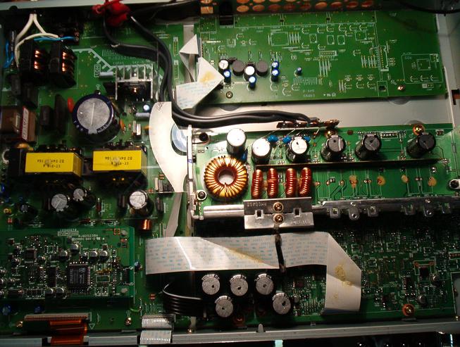

SA-XR10
Hi Folks! (specialy Brian)
Here are some pics of my tweeked digital amplifier. The video amplifiers are gone and also the analog stages.
Now it's a straight line digital. There are also gone the three other channels (i'm a stereo man).
cheers,
Jorge Santos
