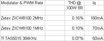

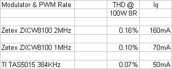

Below is a small table of the same Open-Loop output stage operated from 384KHz to 2MHz into 100W 8Ohms with comparisons of THD & quiescent current due the higher PWM Fs, as can be seen the THD performance worsens at higher PWM Fs: -

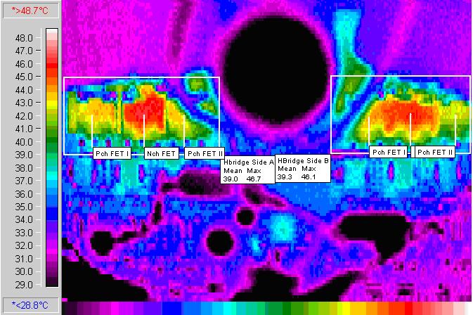

Below is a thermal image of the output stage in the above post. The emittance of the IR Imager has been set to 0.9% to allow correction for the MOSFET package “IR Transparency”, from previous work I’ve calculated that this gives a accurate idea of DIE temperature, and not just the package surface. The output stage design uses 2x Pch and 1x Nch MOSFET’s per H-Bridge side to equalise their RDS-on values.
In fact, it can be observed that the centre Nch devices are hotter than the outer Pch devices on each arm of the H-Bridge (The Black (cold) Circle between each arm of the H-Bridge - in the centre of the PCB is the Bulk PSU reservoir capacitor).
Note: - in the right hand side of the image, the Text label for the Nch FET has been overlayed by the Pch label - but its the hotter device in the middle.
It’s common to see this effect at idle (no signal), due the normally slower switching P-Ch devices causing higher Shoot-thru current in their Nch Counterpart. However, at higher power levels RdsOn losses becomes the dominant heating factor.

The table is interesting: without or with the same output filter?

If you take a closer look at my PWM Fs comparison table, there’s a more then doubling in THD, from 384KHz to 2MHz – this is with the best OPS I can design. This increase has nothing to do with the inductor - reducing its value or even removing completely is not going to help.

The output stage is identical in all respects, only the modulators have been changed (on Plug-in cards).
