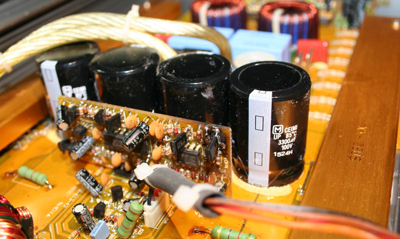

Hey,thanks for help but i made a mistake.I've missunderstood.The items with the problem are the one in the next pic and they have the series erased.

On the right side of the driver board, the one at the top is an LM211. You will find pins 1 and 4 directly connected.
The one below it is likely a TL072 but could possibly be a TL071. If pin8 is directly connected to pin 8 of the LM211, it's a TL072. If pin 7 is directly connected to pin 8 of the LM211, it's a TL071.
Can you please make some marks on the picture just to be sure? Cause i have to explain to another person and i don't wanna make any mistake.Thanks a lot.

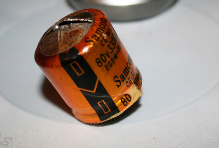

As a preventative option you might consider replacing those PS caps while you are in there. I replaced them with Panasonics ECO-S2AP332DA through Avnet Express. Jus a few bucks each. Mine had a similar driver transistor problem.

You say that nr.1 in the pic is LM211 and nr. 2 TL072 or TL071? Or nr.1 and nr.2 are TL071/72 and the six one at the top of the board are LM211?
Uploaded with ImageShack.us
#1 is an LM211.
#2 is most likely a TL072 but on at least one driver board, a TL071 was used there. That's why I told you how to confirm which #2 was definitively. If the resolution were better, I could tell you for sure.

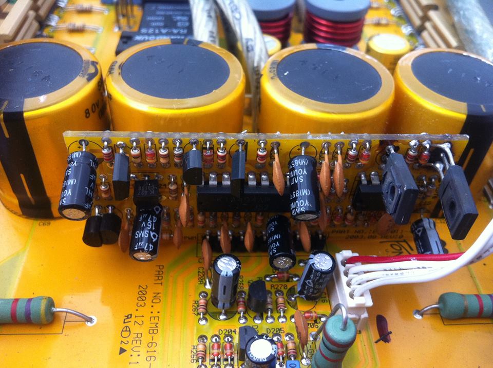

I've found in my pc a clearer picture.Hope it will help.
Looks like imageshack turned the picture 180 degrees. So in this last pic the one from above is TL072 and the other one is LM211. Thanks a lot!
Those six at the top and bottom of card are sot-89 transistors.
AG = 2SA1797 PNP
DK = 2SC4672 NPN
If you must..you can replace those with (for example) AG -> PBSS5480X .. DK -> PBSS4480X
AG = 2SA1797 PNP
DK = 2SC4672 NPN
