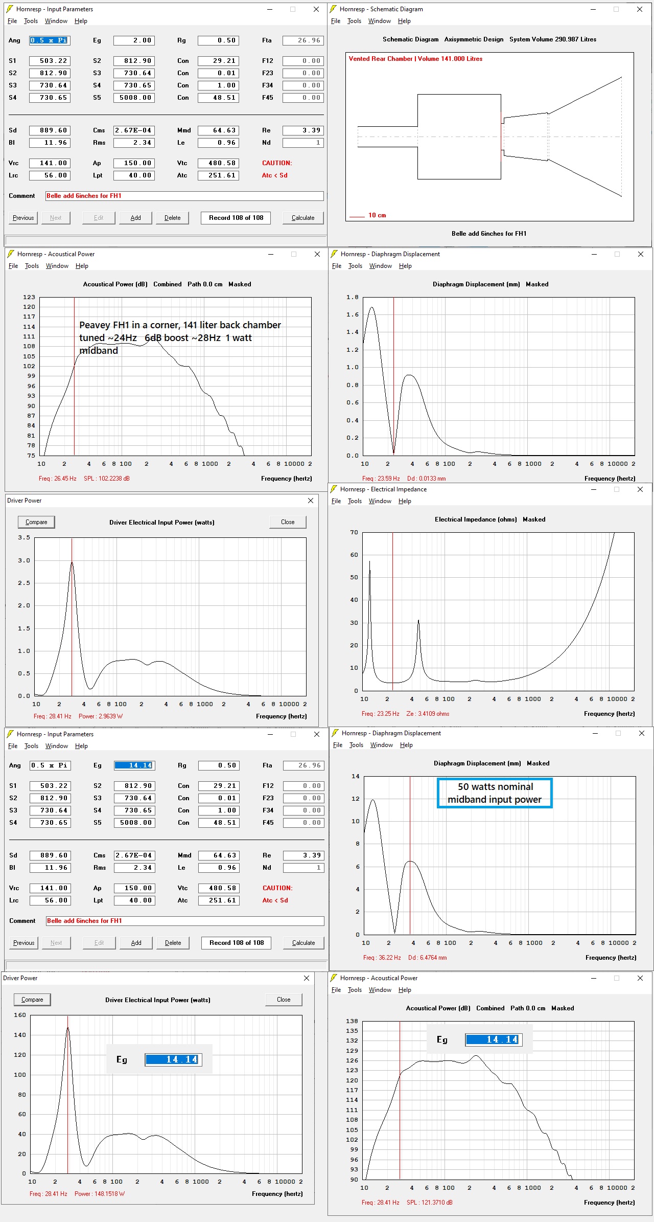

Anyone here take a hornresp stab at the vented Jubilee?
- on the cheap a vented Peavey FH1 with K33 spec could to pretty well if a decent corner were available and handle 50 watts midband and about 150 watts (brief thermal) around 25Hz where the boost is applied.
this is a quick sim but should be ballpark
I'd worry about losing punch in the 60 Hz region
