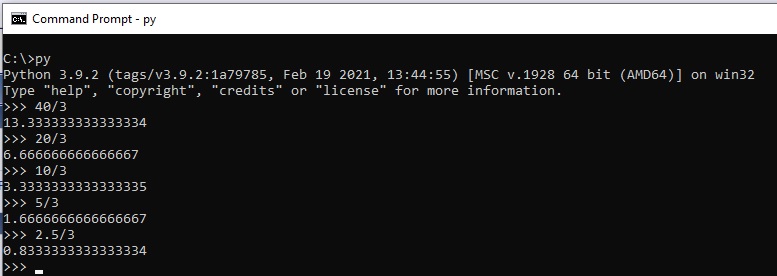

Python math (dodgy last digit rounding):
No, standard IEEE double float semantics - Python shows 17 digits of precision,
whereas double floats have about 16.5 digits precision. Nearly all computer languages use IEEE floating point numbers, so its not a Python-specific issue.
If you want more precision with a floating point number there are modules that can do it.
Basically there are Python modules for pretty much anything. Its extremely heavily used in science and data science with good reason.
Yes, I was half joking about pythons rounding and after >20 years in science technical support I am aware of how ubiquitous python is. Though MS Calculator gives me > 30 digits and it gets the rounding of the least significant digit right, so for on-the-fly paper calcs the basic python shell looses badly :fight:
