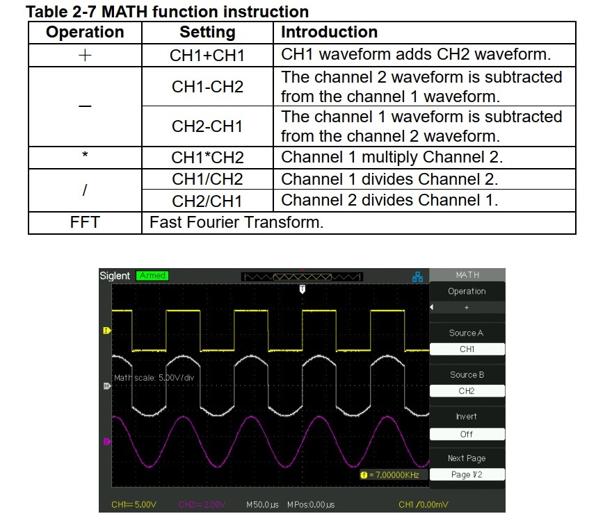

Below is a screen shot of the PDF for my scope, the middle wave is supposed to be a combination of the left and right channel....

I have the same scope it works OK
May be triky ....
1 get the 2 chanels working with 2 signals
2 go to math fuction ... select '' + ''
3 then select the 2 signal to be added '' CH1 '' & '' CH2 ''
4 now I have 3 graphs yellow CH1 purple CH2 white MATH FUNCTION
5 go to second page of math function menu
6 now you have 2 buttons the upper one is for the position of the white graph the lower one is for the scale of the white graph both can be set using '' intensity control '' knob
should work !

the display picture in #10 shows a fully correct +Math trace.
Just keep in mind that Ch1 and Ch2 show different vertical scales.
Ch1 and Math both are set to 5V/div, while Ch2 is set to 2V/div.
Setting Ch2 to 5V/div would immediately show the correctness of the Math channel.

In general - yes.does the ground clips need to be on both probes ?
Math mode CH1-CH2 can simulate the differential probe, but in many cases GND clips must be attached.
Why it works without this? Many scopes have connection between input's GND and PE contact. If the exploring device is also have the connection between it's GND to PE - both GND's will be connected together through the mains. Even without PE connection, due to a leakages and capacitances, it can "work".
But, it is not good for some reasons - this create a big loop, so you can get a lot of noise. Also scope's probe with it's cable will not operate properly at the high frequencies without GND clips connection.
So, if you want to measure the signal between 2 non grounded points - use or differential probe, or 2ch scope with math, but connect GND clips and pay attention to the voltage from these points to ground (not more than written at the probe and scope input).
