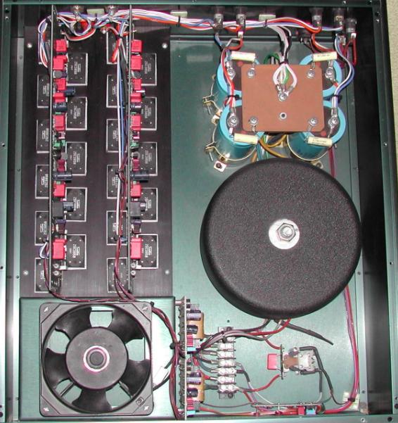

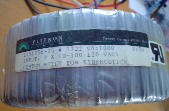

excetara2 said:
Did they sound good?
The Class A model rates very good in my book(KBA-75, Parasound lookalike)
The high power AB models are excellent for parts recycling. :clown:
ps: cooling of the Class A model was by a fan/heatsink duct combo.
