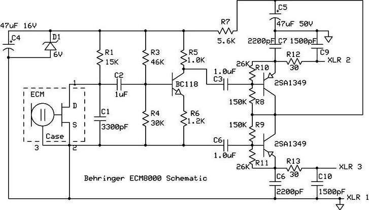

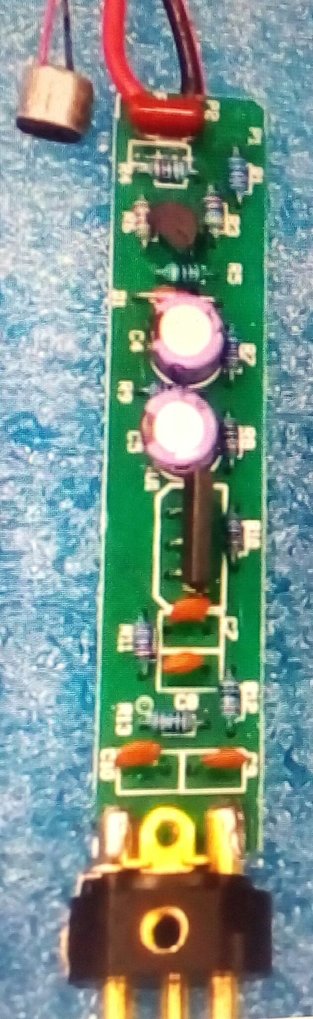

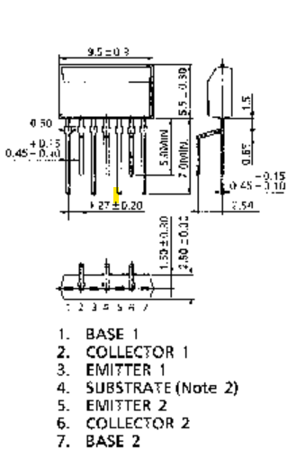

Wik Member Joined 2021 2024-06-27 4:04 am #1 2024-06-27 4:04 am #1 JonSnell Electronic Member Joined 2012 jonsnell.co.uk 2024-06-27 8:54 am #2 2024-06-27 8:54 am #2 Make and model would help but it looks like a simple pre amp so why not create a schematic. Logon Member Joined 2012 2024-06-27 9:00 am #3 2024-06-27 9:00 am #3 Here it is. From here. Wik Member Joined 2021 2024-06-27 10:22 pm #4 2024-06-27 10:22 pm #4 sorry to say , but the photo only have 2 transistor B bucks bunny Member Joined 2020 2024-06-27 10:41 pm #5 2024-06-27 10:41 pm #5 You should show a photograph from pcb bottom side as well dimitri Member Joined 2002 2024-06-27 10:41 pm #6 2024-06-27 10:41 pm #6 The black box with seven pins is a dual pnp device Reactions: Wik, Logon, Boydk and 2 others Logon Member Joined 2012 2024-06-30 10:39 am #7 2024-06-30 10:39 am #7 Wik said: sorry to say Click to expand... Sorry if we helped you... 😍 Reactions: Boydk, nr12, bucks bunny and 1 other person You must log in or register to reply here. Share: Facebook X (Twitter) LinkedIn Reddit Pinterest Tumblr WhatsApp Email Link Home Live Sound Instruments and Amps anyone have schematic of this?
